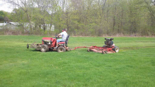

I figured Id throw a couple pictures up of my Steiners at work..these machines never stop working....the older one we took delivery of in april of 1989 brand new and is still in service today...broke 4 hr meters so far and probably has 11000-12000 hrs on it conservatively..

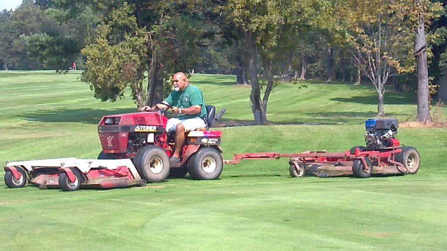

last pic is my dad mowing pulling the attachment i built..maxhine has a 6 ft Ventrac deck and pulling a 5 ft Steiner deck for a total of 10ft cut with overlap...

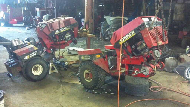

The 1st and 3rd pics were from last year..it was a bad week both Steiners down waiting on parts! We broke the RF axle mount for the lift.. a 6 ft deck and duals puts a lot of stress on it...old steiner is waiting for a new hose so i dropped the front axle and went thru the hydraulic motor ..wasnt in bad shape for never being touched....i resurfaced everything and put new
bearings in as PM...

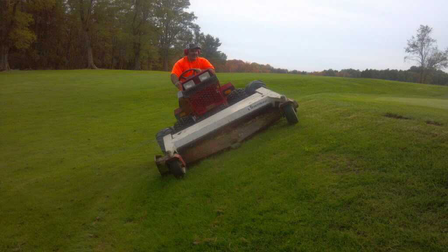

A few action shots doing things only a Steiner or Ventrac can do....

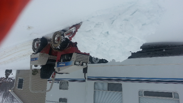

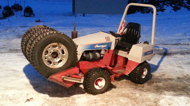

Here's 2 more from this week. One plowing with the slip scoop and the other moving my snow tires to the truck.
