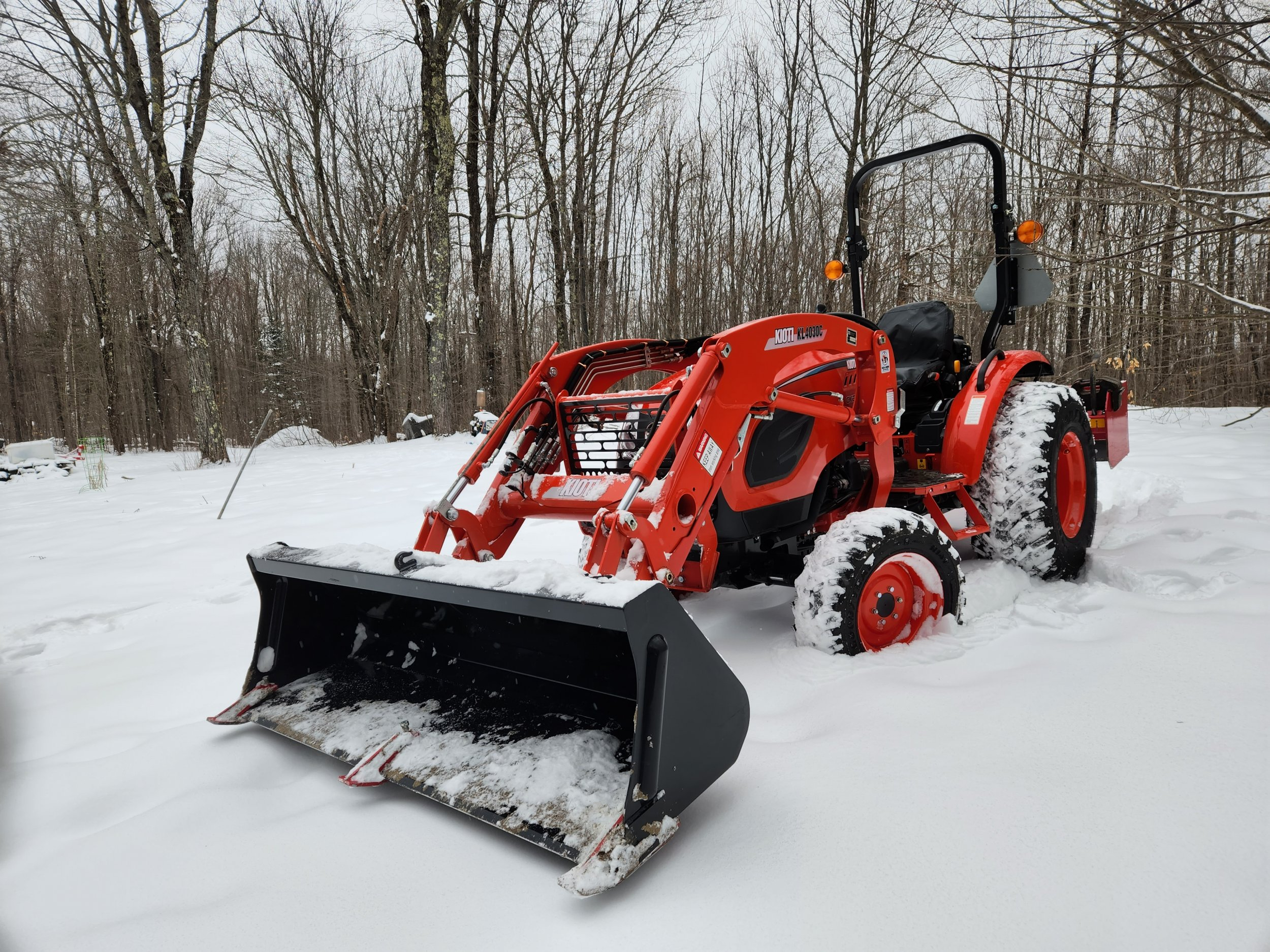

My CK20S runs fine and does most of what I want, but lacks in a few areas.
I am "thinking" about looking at alternatives.
I like the CK20 size, but know I will have to go slightly larger to get the "perfect" tractor,, but want to stay as small as I can.
But the things I NEED to upgrade are:
1) FEL lift capacity- The CK20 is 1100# at the pins,, I would like around 1300 at the pins
2) 3 range transmission,, the 2 speed ranges of the CK20 is everyones gripe. (I would consider a manual with shuttle)
3) Backhoe attachment that shares the tractor's operator seat. The CK20 has the fuel tank behind the operators seat, so the BH need
it's own seat. This arraignment puts the whole BH attachment rearwards and additional 2' or more, adding excessive length to the overall setup.
Additional things I want:
A full frame like the Yanmar SA424 series.
Any way to avoid tier 4 engine ??
So what exist that meet my Needs and possibly wants?

Used would be fine.
My property is 20 acres of my home/homestead, oak forest, creek bottom.
I use the tractor to cut and process firewood, this is where it struggles - lifting IBC totes of firewood.
I have a PTO tiller and post hole digger,, fences, garden, food plots , lawn restoration.
Pallet forks for moving various materials (always have a project or 2 going on.
FEL is used for general homestead work.
Backhoe is not used much, but when I need it, I need it. And renting one/picking up/returning it for an hours worth of digging will not work for me.
Yeah 24.9 HP with a 3 speed HST would work, as would a manual with hydro shuttle.

The L39 is to much tractor in all aspects, Size, weight, capacity, price.
The B26 seams to fall right in most aspects,, wonder if you can remove the canopy and just run it with RPOS?
The Kioti CK20 is a good match quality and price for my use,, I put 360 hrs in 10 years, I will be putting more hours, maybe 10-20% more per year. Definitely not looking to step up to Kubota construction/rental line of machines.
I like the CK20,, I just need about 200# more lift out of the FEL and a 3rd speed range,, But is I spend good money on another tractor,, I want the BH better thought out,, The CK20's BH hanging into the next county gets on my nerves.

The FEL capacity is the biggest and what prodded me to even think about replacing the CK20.
If I had 200# more lift at the pins, I would be "OK",, 300# more and I would be golden (I typ have the 5' tiller on the rear, and have loaded rears)
The 3 speed ranges and a better thought out BH setup are things I would WANT if I was spending 20K on a new setup. But those 2 things are not enough to make me get rid of the otherwise great little CK20 (If I increased the FEL lift)
But in the end, I paid 11.5K (2008) for the new CK20S with FEL, loaded rears, welded on bucket hooks and pallet forks (Walace Tractor), and it only has 360 hours on it, so not liking the idea of going into debt.
