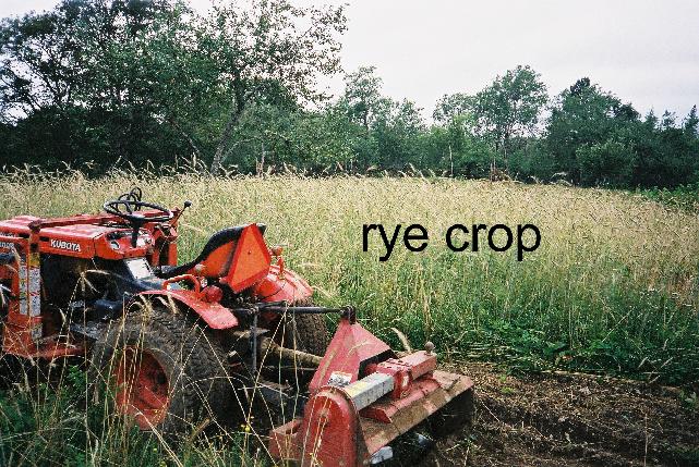

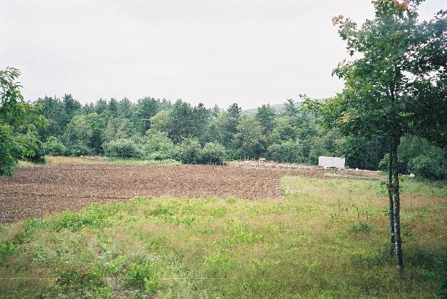

Bob:
A picture of a field that was not worked for 50 years that my B7100 and rototiller have worked up. It was heavy sod and has many a rock.:D
