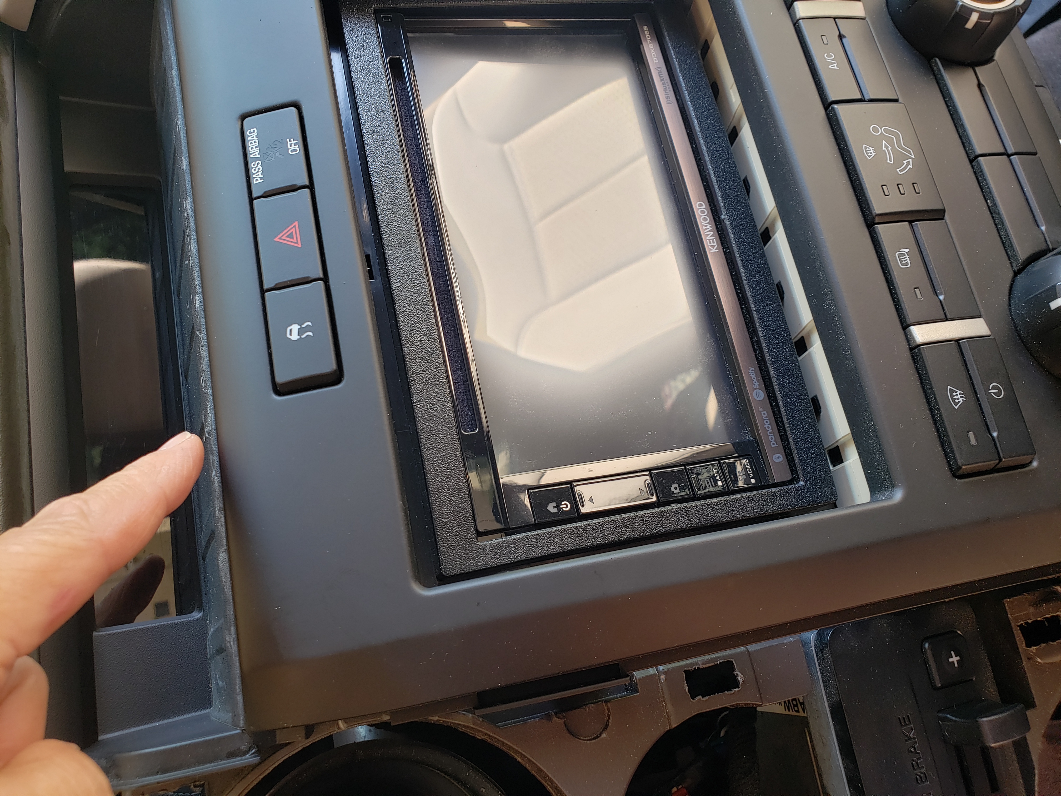

Did similar upgrade in my 2010 F150 last year primarily for the backup camera but also to get Apple Car Play and Android Auto. Also added a sub-woofer. But, I paid an installer to do it for me. From what I recall you will need the head unit, backup camera with wiring, a wiring adapter to make your steering wheel controls still work, a new face-plate, and i think also an adapter for the head unit wiring too. Love the upgrade as I now have access via the head unit to Spotify, etc., plus navigation through the HU using Android Auto. My truck only has 67K miles and is more of a third vehicle now, so plan on keeping it for years more.
If you install it yourself, check on YouTube videos for some help. I actually had to take the face-plate off as my USB connection to the HU fell behind the dash. Wasn't that hard to remove once I watched a few YT videos. Of course I was not doing a full install, but getting to the guts isn't too bad.

Is that the final install with everything in place? And that was done by a professional installer?
   / Stereo head unit with backup camera in 2008 Ford #6
Sort of. I took that pick a few days ago when trying to take the face-plate off. The new face-plate is partially loose and the trim to the left of the face-plate (if you look close) was already removed. I will post a better pic in a bit.
Oops, your last question. Yes, took it to a stereo, etc., installer where I bought all the components with installation.

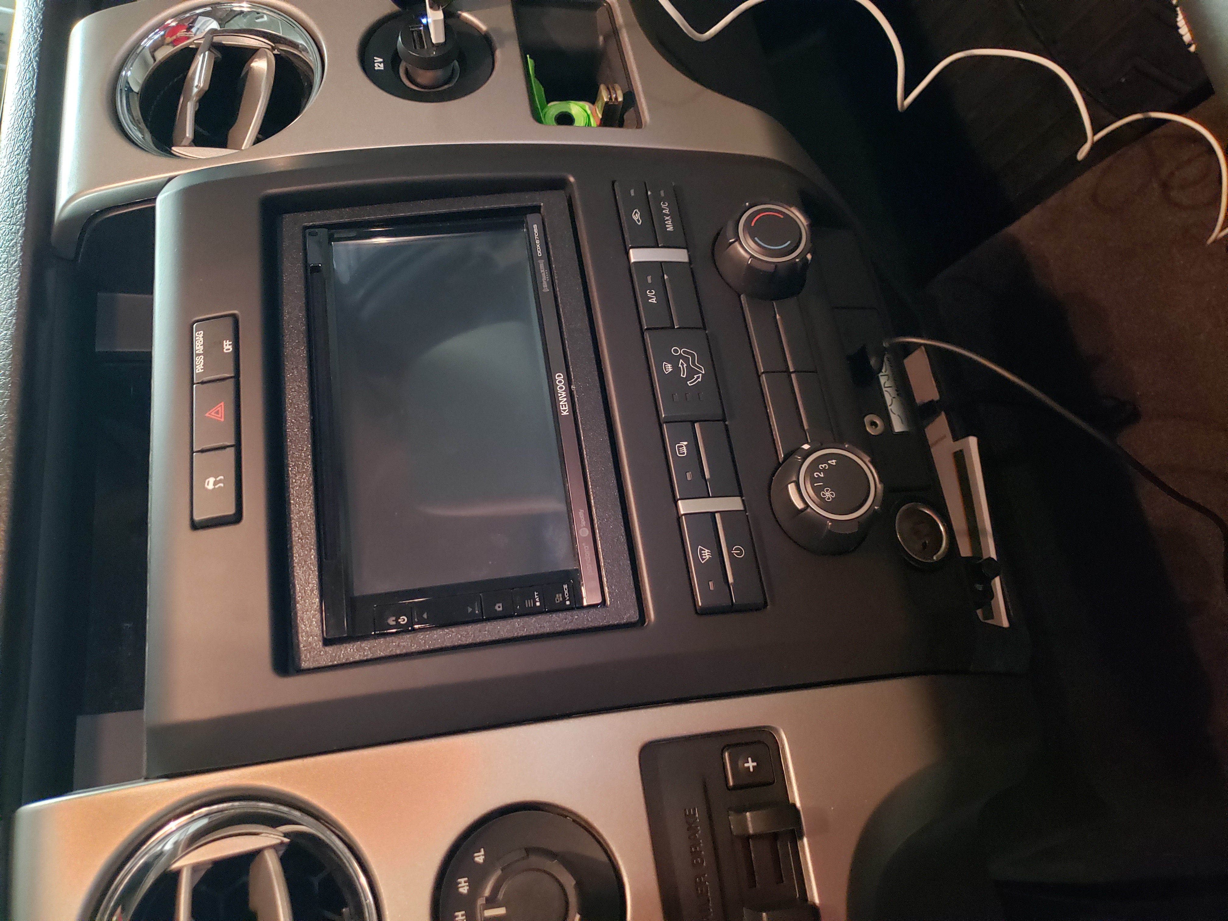

Better pic with everything put back together. Pic looks sideways in preview, but correct when I click on it.

That is something else Crutchfield sells is the plastic pieces that fill in any gaps and make it look more factory.
