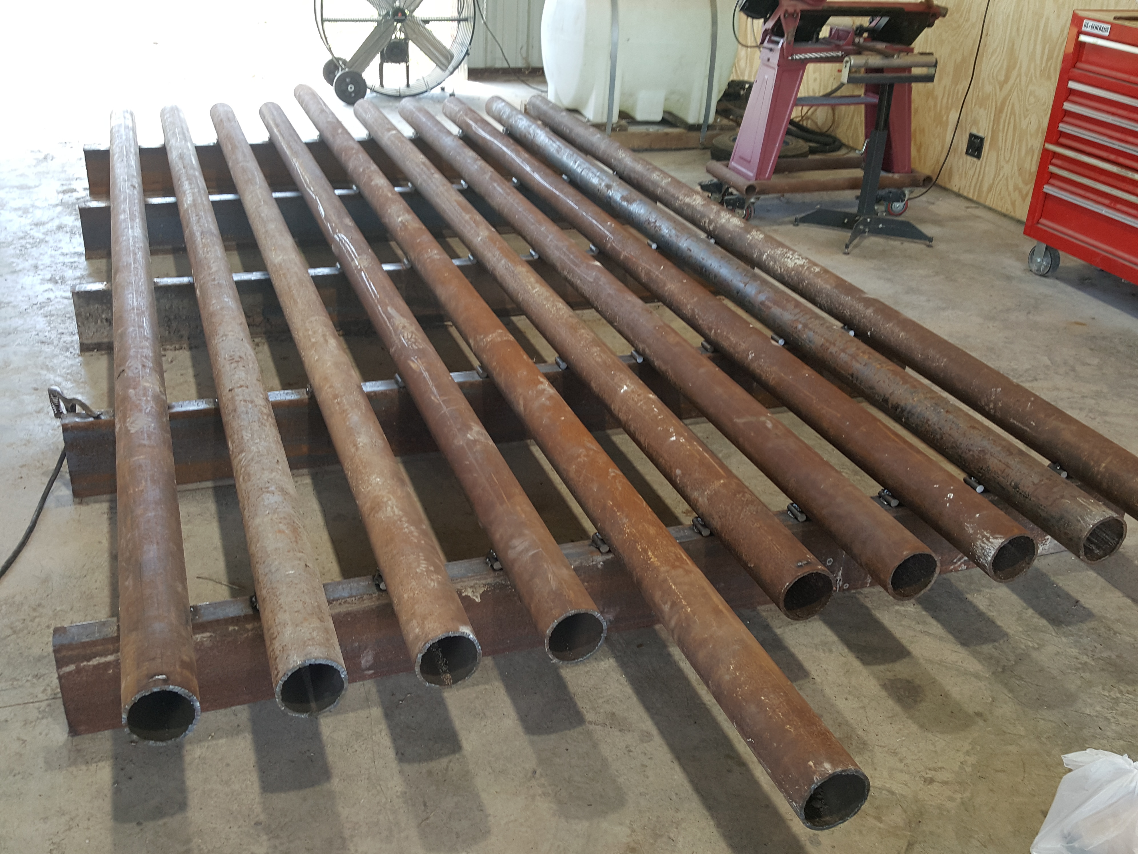

I'm working on a cattle guard. I tacked it together with MIG and now welding it up with 7018.

All the cattle guard failures I've seen are at the weld between the pipe and beams. Since the pipe only touches the beam at a point, there's a lot of leverage on the weld. I'm attempting to make something like a saddle so the pipe is held by two welds. Will see how it works first time a cement truck runs over it. :)

I've seen your method used before and it makes perfect sense in my opinion.
Plus it's not easy to weld way underneath a tube anyway - your method makes it much more accessible.
If a cement truck breaks it, maybe a few cross ties would cure that?

It seems like a very smart idea for a stronger joint.

I'm not sure how smart it was. It doubled the required welds. I stick welded for 6 hours straight. Granted, I stuck a rod 1 out of every 3 restarts and I'm not a great SMAW welder.

This is why I like GMAW (MIG). Not trying to start a debate here!

If i ever make another, I'm going to get some dual shield wire.
