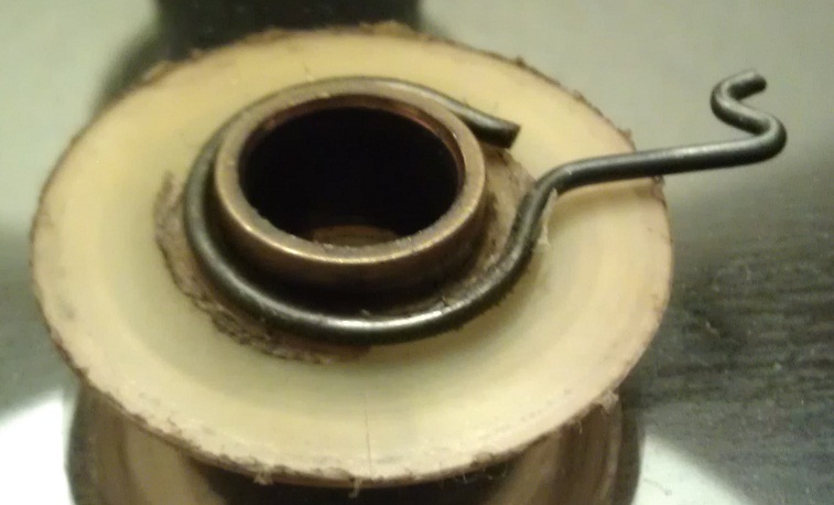

I was cutting a few weeks ago and the chain/bar sounded wrong. Stopped the saw and noticed the chain and bar looked drier then it should. Pulled the bar off to clean stuff up. Started saw with out bar on, revved it a bit and no oil.
I pulled the clutch and the worm gear was messed up where the metal clip was attached. Here's a picture.
Replaced it and it's oiling again. Got a lot of clean up from the ice storm. Firs tipped over, alders broken and a few larger cherrys hung up in trees.

Wow, kinda rare. Just one of a kind freaky thing or do you think something caused it ?
What's your choice of chain lube ?
(Just curious, not implying related to failure)

Unfortunately, I bought it several years ago and now whats left is in a half gallon jug that used to hold another brand of chain oil.
It's probably something i got from stihl, thick like red syrup and slicker then snot.
I really don't know what happened, but it looks like the plastic got hot and spun out into that disk shape, almost like the worm gear stopped turning and the wire kept spinning around. It didn't seem very cold outside, maybe high 20's so i don't think the oil would be that thick.
