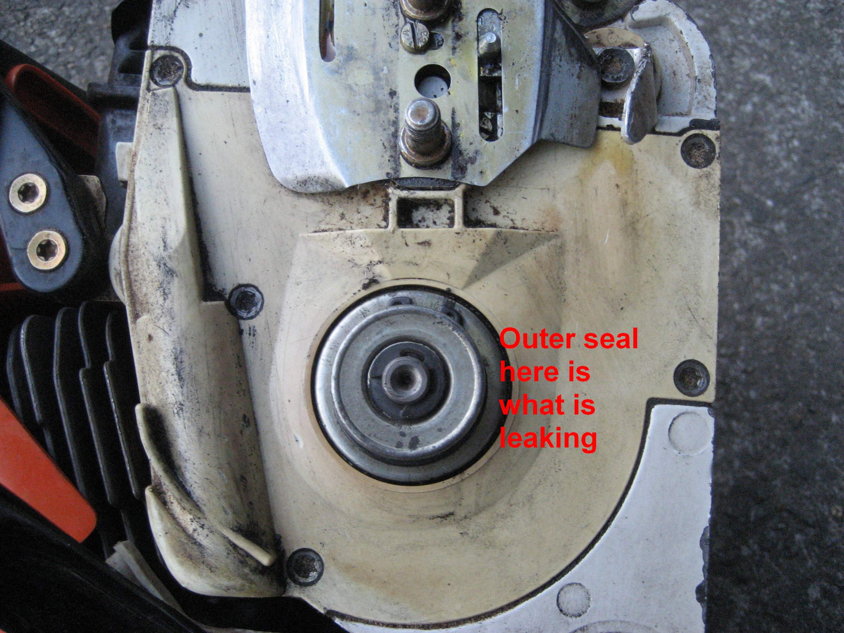

Need some help....I was cutting on my property today and the chain saw started slowing down....ran it a little bit longer and decided to stop....chain sounded "dry" and was not running as freely.....checked the oil and found none (very little) in it......once home filled up with oil and cleaned all passages.....cranked it up and black oil started to come out from around the spindle?? Fresh oil was coming out of the holes for the bar.....
Have a burned up a seal?? easily fixed?? Anyone have a parts diagram on this saw??

I said it was a problem....but I figured out what happened. I was cutting some wood, heard the chain rattling and realized that I had run out of oil....it was really hot....when I went home I filled up the reservoir and then put a little oil on the chain and the sprocket at the end of the bar....cranked it up and ran it for a few minutes.....cut it off went to do another project...when I came back there was a thick black oil puddle on the garage floor and coming out of the area in the picture in my first post.....wiped it up .....cranked it up...the black oil started coming out again....now I was getting concerned that I have damaged something......
Today I pulled off the cover and bar again.....cleaned off all the areas......cranked it up again and good fresh oil coming from the holes/ports for the bar...just a little bit coming from the spindle area......cleaned the area with mineral spirits....dried it off.....ran it again.....no oil in the spindle area....
Figured out the oil from last night when I put on the chain and sprocket had worked its way into this area and then picked the dirt from the chain etc....that was the black oil on the floor....
False alarm....Good news is no damage and my trusty 22 plus year old chain saw is back together....well lubed and ready for the coming weekend.

That seal is not that bad to replace, but if that one shows how far away is the one on the other side att 20 plus years old!!!!!
I'd be pulling the exhaust off and looking at that side of the piston!!!
