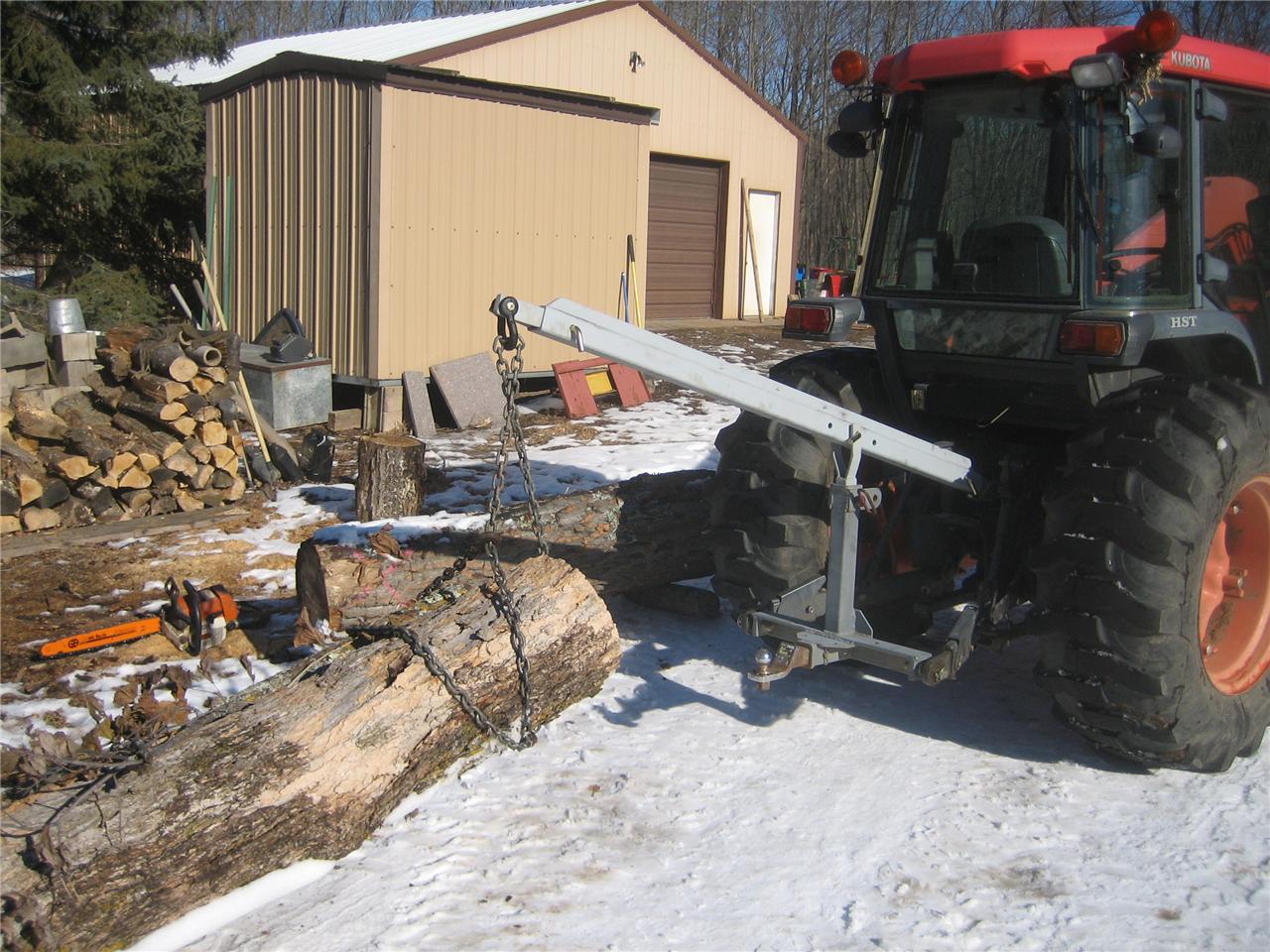

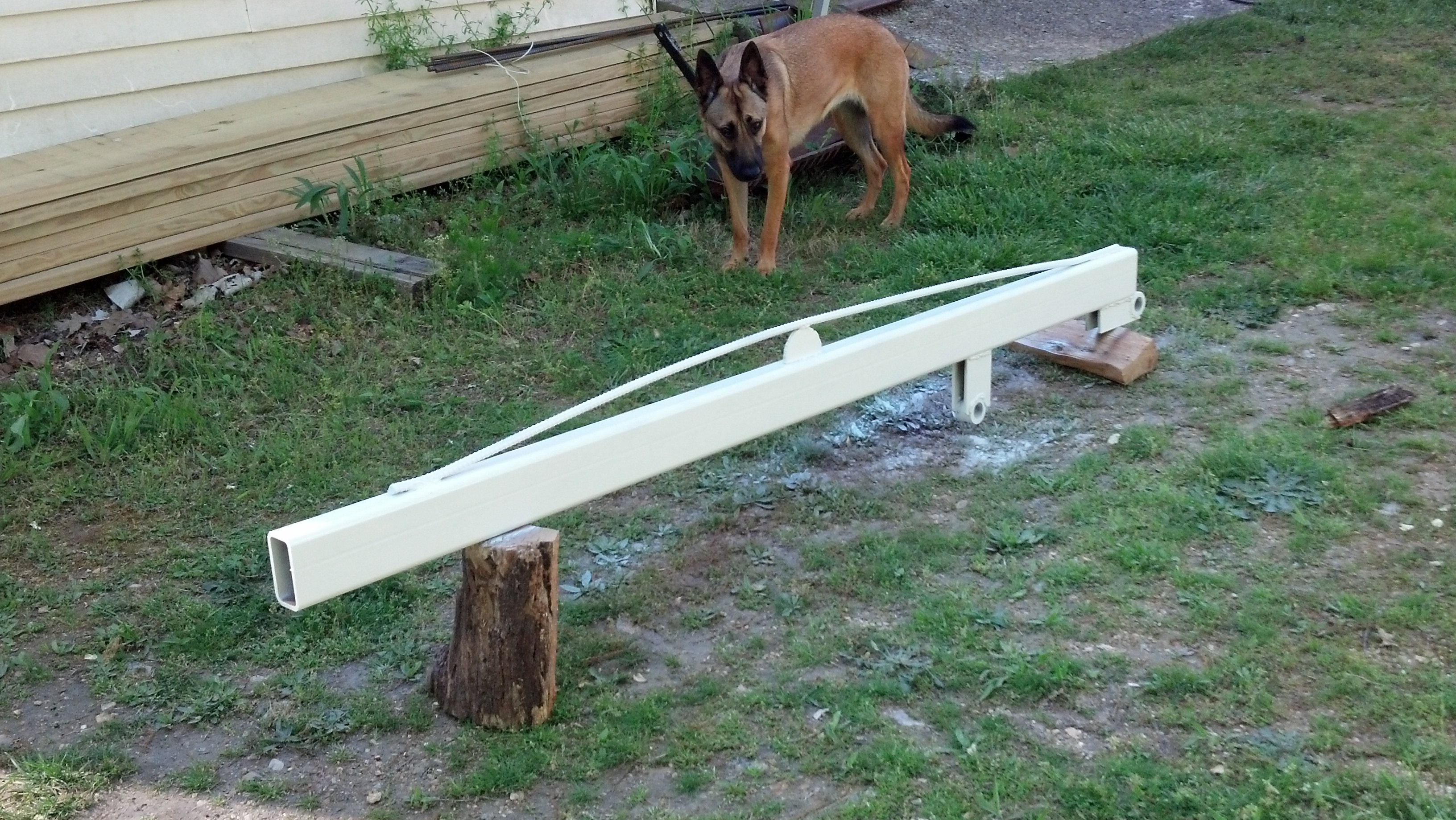

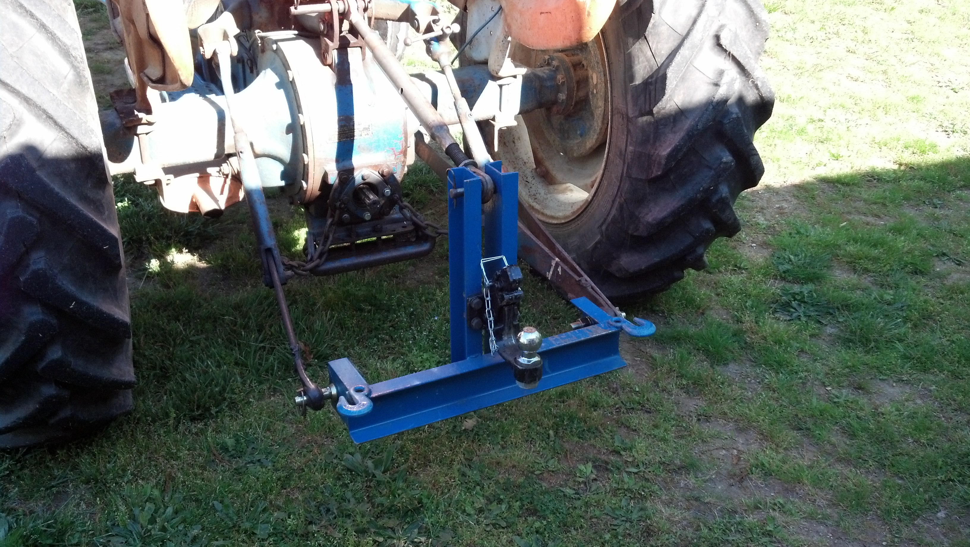

I would use the 3 PT TRAILER HITCH OF DEATH and substitute the toplink with the boom. So one end of the boom connects directly to the tractor, the other connection point is the 3 PT TRAILER HITCH OF DEATH. I had some metal and a bought some more rectangular tubing. Made some measurements, tacked some welds. Dog looked at it and said "cheat a little and move the lift point back an inch or two till you max out your lift height" then the dog yawned, snapped at a buzzy insect, then proclaimed "Set the pivots deep into the supports to increase the weld length." So with those insights, I welded using some Lincoln 7018AC on DCEN. Not pretty welding but a hot root pass and good enough for an office puke.
Above: 3 PT TRAILER HITCH OF DEATH
Above: 90% completed BOOM OF UNLIMITED LIABILITY
Behold this extra fitment to certainly result in a meager company provided life insurance payout to my better half. Note the lack of SAFETY DECALS with stick figures getting their skulls dented by falling objects. This should guarantee the TOTAL LOSS OF TRACTOR AND BLADDER CONTROL that the 3 PT TRAILER HITCH OF DEATH has yet to achieve sua sponte.
Those round thingys will have bushings inserted to bring the ID's down to clevis pin OD. Yes, I know the left stabilizer bar is missing because the A-C5NNN455-C sold to me by A & I Products isn't really sized for the 3600, despite being advertised as such.

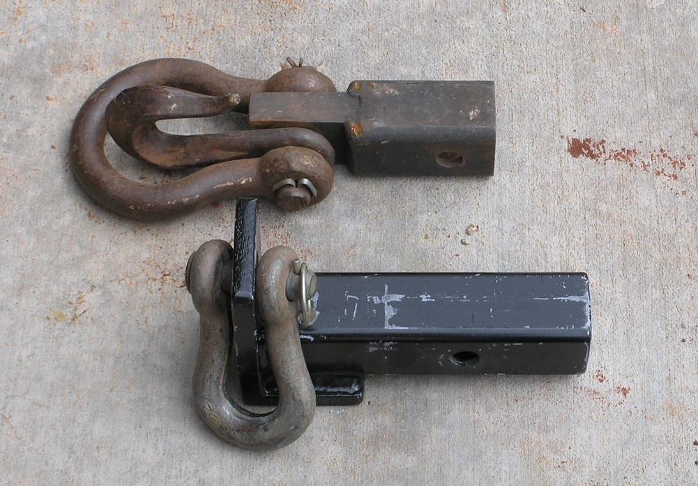

I wa wa wa wonder what to put on the business end of this. I thinking a 3/8" chain hook and some kind of big hook for a sling ring my neighbour gave me. Suggestions welcome, photos better still.
So there it is and now I yield the floor to include the cacophony of nattering nabobs of negativism who've not endeavoured anything enterprising since Agnew.
