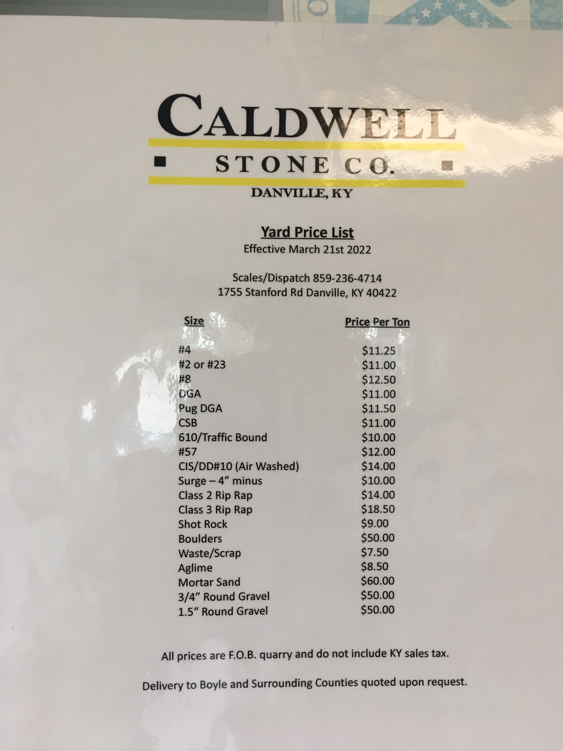

This is what the different sizes are called in Danville KY.

You are likely correct about our 53's. There are some large rock in there. Once they surface it is an issue. Grading packed 53's is tricky. It must be moist to really get a bite and mix it back up. if to dry, you have a blade full of marbles!
Cost for stone here is pretty cheep, Last time I got a tri-axel of 53's it was $250-ish delivered. That is 20 tons spread.
