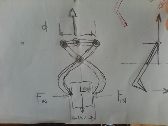

Hi All DYI'ers

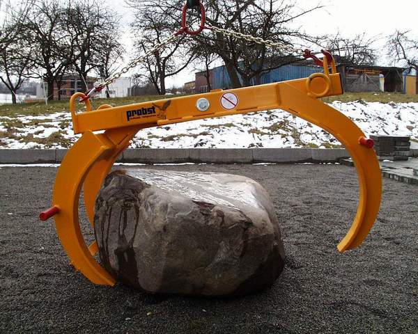

I want to build a stone grab as per sketch. I have a ute crane and intend to mount it on the 3pt hitch of my tractor and attach stone grab to the crane.
The whole purpose of the exercise is to be able to lift, carry and place stones (<250 -300kg) on a stone wall build. The crane is rated 400kg at full extension (5ft) and 900kg at 3.5ft and has the thrust bearings to accommodate these loads on the swivel.
Would appreciate any advice etc. Sorry no dimensioning as yet but envisage grab opening of 350 - 400mm.
log grab.jpg.
Cheers from Australia and thanks in advance.
fefty

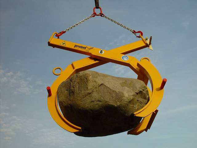

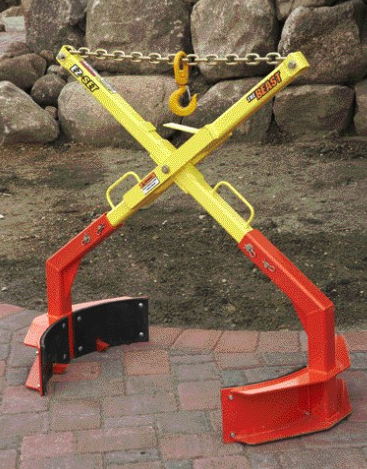

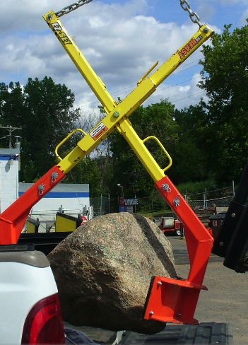

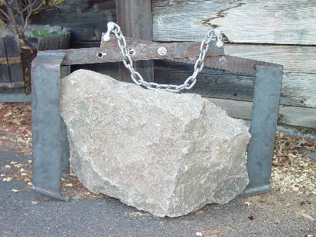

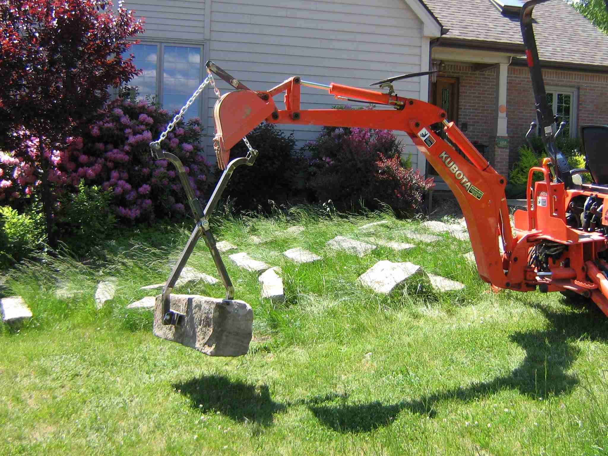

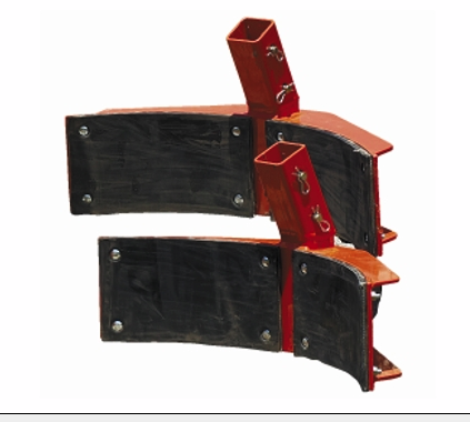

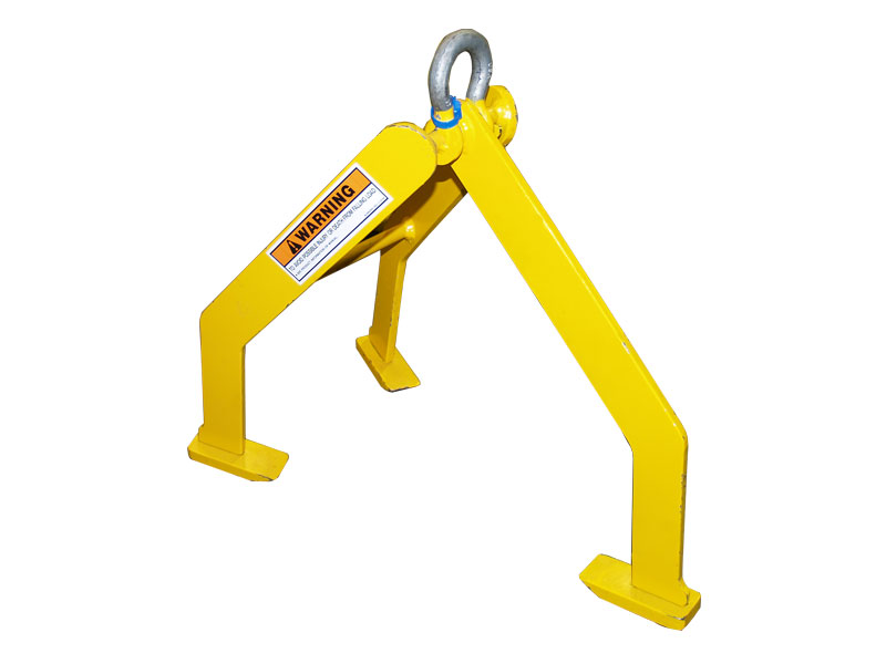

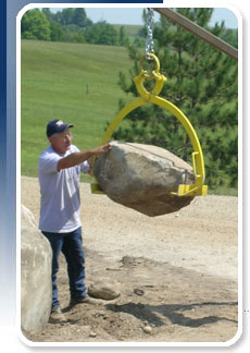

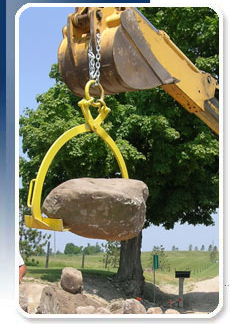

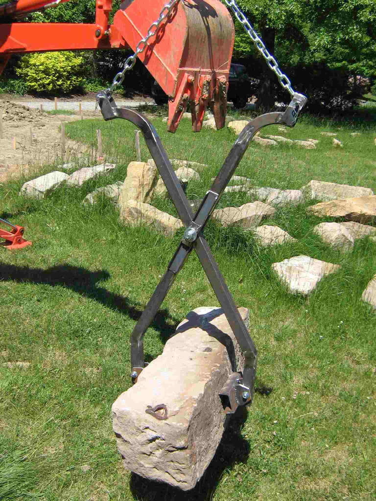

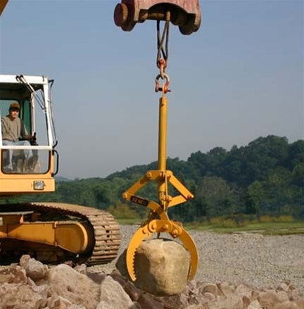

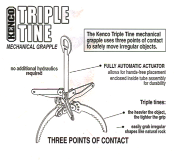

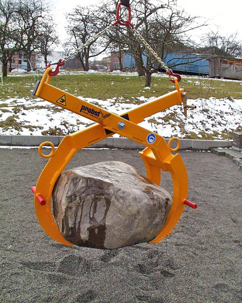

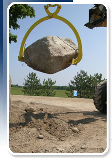

All of the rock tongs I've seen have three fingers or two with wide pads. Just two will allow the rock to turn and twist depending on exactly where you grab it.
I've been collection photos for build ideas. Here are some.
491614-DSC00931_20.JPG 853933-Rock Grapple1.JPG 866965-Mechanical bolder grab.jpg 1004410.jpg about_left.jpg faq_left.jpg fvz_01.jpg fvz_02.jpg index_hero.jpg K-TT-Grapple-2.jpg K-TT-Grapple-4.jpg quarry tongs 2.jpg Rock Lifter.jpg rocktongs6.png rocktongs9.png rocktongs12.png Tongs.jpg tt-line-drawing.jpg x_gall_1.jpg
   / Stone Finger Grab Advice Sought #3
A person could find more uses for something like that, picking steel, parts, wood etc.. I like the smaller one hanging off the backhoe bucket, lower center.
