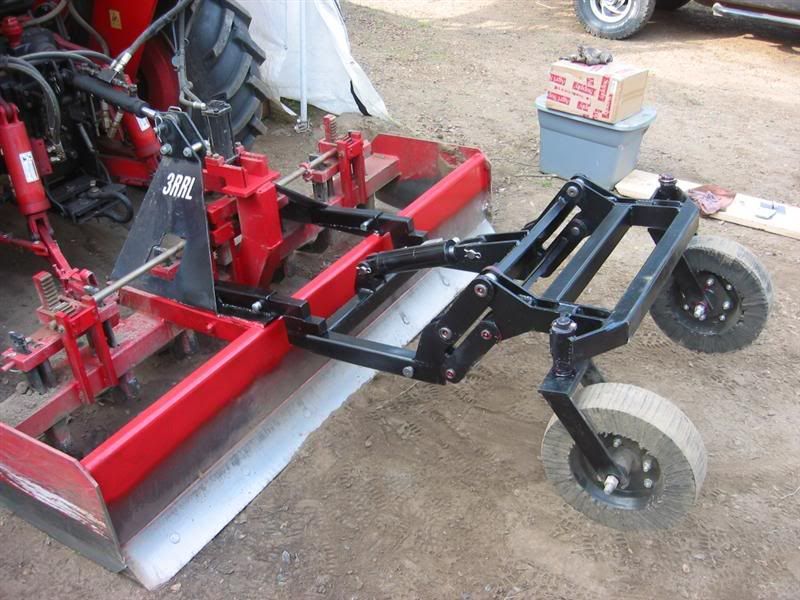

They do come with gauge wheels on the high dollar hydraulic professional grading ones. If you build them yourself, you can add them on to our kind of boxblades we are using on our CUTS, which like you say, usually don't come with them. Here's a set I made to use on the rotary cutter, boxblade and soon the landscape rake. They are Quick Attach.

Vern,
Maybe what I did when I built my RB will help give you some ideas on what you can do. I HIGHLY recommend using 2 wheels for stability. Gerard's suggestion of using a top link is what I did.
Mine can fold up because the part that attaches to the wheel frame can slide on the shafts to 2 different positions where it is pinned in place. Putting it "over center," allows you to get almost up against a garage door, building, or whatever. However, when it is pinned down you have very precise control of the blade position.
There is a close up of what I did. The wheels are to the right.
The wheels really help in getting a smooth surface with a whole lot less skill, frustration, and time.

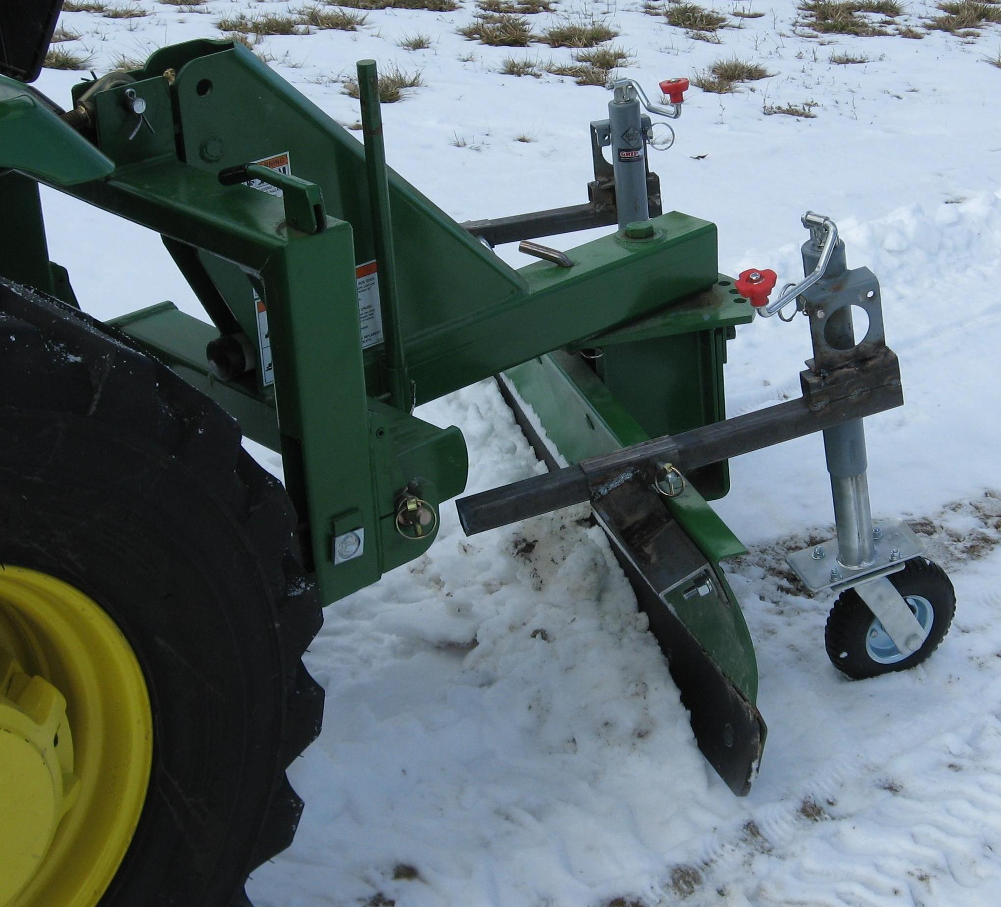

Here's mine. I'm going to adapt these wheels to work on my landscape rake in the near future.
Word of caution, the cheapo HF air-filled tires seen in the picture lasted about an hour before blowing out and have since been replaced with solid rubber tires. I've read reports from others on this site of the same experience.

Looks like some great ideas there. Those pictures got me to thinking why not use receiver hitches from trucks as your quick disconnect for the gauge wheel? That would be a bit of overkill. They are fairly cheap and sturdy. Then you can compact your system for storage. Although the flipped up set of wheels is an even better method. Solid rubber tires does make sense for the amount of pressure exerted behind the tractor.
Runner, did you sneak by my place and copy my idea? Well great minds think alike!!
You did exactly what I did; I bought steel surplus tubing the same size as trailer hitch recievers for the blade and rake then longer pieces for the extensions to slip into the recievers. So now you can have different length extension bars, the smoother the grade desired use a longer bar.
Then bought 2 trailer tongue jacks and the largest swivel casters with the rubber tire (on sale at HF). Bolt the caster to the jack pad.
Now I can extend my wheelbase for smoother gradeing and adjust the jacks to level or crown a surface (road) as desired.
JUST REMEMBER WHEN MANUEVERING ,YOU NOW HAVE SOMETHING THING STICKING WAY OUT BACK.!!!
   / Stop the wave while leveling #9
Joe,
I don't remember exactly who I copied my gauge wheel design from, but I definitely stole it from someone on this site.
RE: using receiver hitches - that's what the person I stole the design from did, and that is the right way to do it, or at least use material of that thickness. Instead, I used lighter gauge tubing and I'm afraid it may not be heavy enough. It looks like it's straining with just the weight of a 5 foot rear blade. Not sure what it will do when attached to the 6 foot landscape rake.
At any rate, if I was doing it again (and I probably will be) I'd use the thicker walled material.
On the other hand, the trailer jacks do work very well for this, although I had a little trouble welding them to the tubing without burning through the tube of the jack (attributable, I'm sure to my less than stellar welding skills).
Still, the design worked and I levelled 25 tons of gravel on my driveway this spring with this setup and it made the job easy and quick. I'm just not a good enough operator to do this without gauge wheels.
