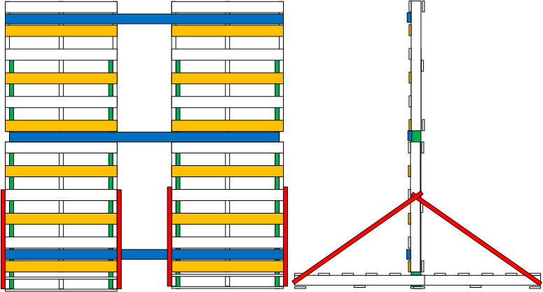

How big of an area are you trying to block off? 20' wide? 50' wide? 100' wide?
If its up to 20' wide, I would take pallets and paint them white and florescent orange (or some other florscent color).
Here is a diagram of how I would do it. ~2' between the pallets and make them at least 2 pallets high.
Color key:
Green = Vertical 2x4s to hold the two pallets together
Red = 2x4 Braces to hold the pallets up
Blue = Horizontal 2x4 braces to lock multiple uprights together
Orange/White = Pallet
I would also put no-trespassing signs on the pallets and a game camera to catch people who try to mess with them.
