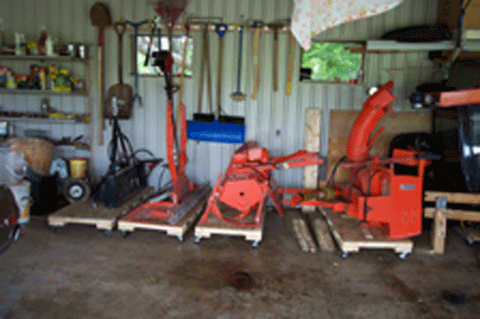

The attached shows how I store my attachments. Whenever I need one I just pull it out of the line, turn it sideways and attach it to my tractor. Each pallet is 2' x 5'. The frame is made from 2"x6"s and the top is sheathed is chipboard. I have fixed 2.5" plastic casters on one end and 2.5" swivel plastic casters on the other end.

Mine aren't nearly as neat as those pictured, but do serve the purpose. I purchased car dollies (each holds 1000 lbs) for about $30 (2 in a set) and put boards across them. This works really well for my 72" Box Blade, Ballast Box, and other implements. They roll very nicely across the concrete floor in my polebarn and sure make the attachment process easy.
-Bob
