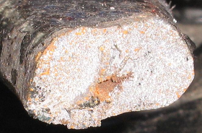

Well. I managed to really break my new KAMA 354C and I'm stuck in the jungle!
My steering arm broke and my Right wheel is turning Right, while my Left wheel is turning Left! Darn, why couldn't I break it while it was in my garage.
Anyway When sitting on the tractor, the LEFT arm is broke, but my Parts manual calls it the "RIGHT Steering Arm". Page # 29, Item #8, Part number 254.31M.168. According to the Parts manual this is the same as the 254 also.
I hope I wasn't too rough on her today. I was driving through some ruts that my rear tires dug when it went bang, but I think it's a MFG defect as the center is slightly hollow and has signs of rust where it broke.

I'l admit I had a lot of weight in the grapple when backing up just before she snapped the steering arm. And further checking found a stump cut off below the surface of sand.
But I'm hoping this is a MFG defect and I don't have to baby this thing too much to avoid another break.
I tried to attach a picture that shows the void going through center of arm and has signs of rust. But the error message I gets say I can't exceed 10000.

I don't know how much weight was in grapple when it broke. But it was a small tree. Approx 6 inches at base and tapering off as it reached about 25 feet. Probably 300-500 pounds?
I had it in 4WD when it broke. The only way to get through the Sugar Sand is in 4 wheel drive even without a load.
I think I can attach the picture of broken arm now. It has rust in the center where a small air void in casting occured. Not sure how deep the void goes but it about 1mm x 10 mm (H x W).

That is just one ugly piece of casting. Slag inclusion, voids, grain size are just a few things come to mind when seeing it.
Egon
