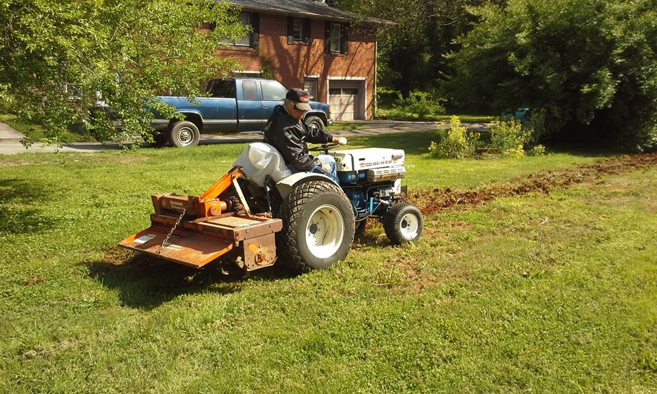

I have a Satoh (Mitsu) Beaver. We stripped the splines on the PTO yolk and are having trouble finding a replacement. Anyone suggest a parts source for this? satoh2.jpgsatoh.jpgsatoh2.jpgsatoh.jpg

Tractor Supply carries yokes and pto couplers, I've heard of one NAPA store that has them. A dealer who sells the line of implements the yoke came on could probably order one for you. It won't hurt to check all the nearby dealers I've known a dealer to have a business connection with a company even though nothing of their brand was on his lot. There's lot of them on ebay, too. Happy hunting.

Is that pto Universal 6-spline, or early Satoh / Kubota with a larger number of smaller splines? If the latter, try a Kubota scrapyard.
