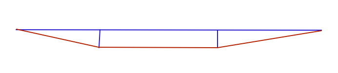

Need some quick help. I need to turn this 20' old fire escape ladder into a 20' bridge to hold up a 180 pound graduate student. The "brackets" were used to hold it to the building. I was hoping to either use a 20 foot flat stock and bolt it to it (#1). ...or (#2) I can use 1/4" angle iron or other suggestions??? ...or (#3) use a 20 foot treated 2x6 or 2x8" bolted to this AND along the side rail. Gotta get done by Sunday!!!
It's pretty heavy but so far we can deal with it.
View attachment 464721View attachment 464722View attachment 464723View attachment 464724View attachment 464725View attachment 464726
   / structural help for a foot bridge... #2
Flat stock, maybe 2 x 1/8, run as in the red line in the drawing. Remove or disregard the end brackets.
Bruce
I wondered about that, makes sense... I can do that. So 1/8" is enough? Price doesn't matter (but weight does a little bit).

QUESTION, Should I bend the ladder before I mount the "red" band of 1/8" metal?
   / structural help for a foot bridge... #6
If you are going to add a truss, keep the ladder straight. I think you might be able to use the attachment legs to hold the truss in the middle if there are two of them and then just have to remove the end legs. If done right, you could then attach the flat bar to the cut off legs at each end.

There are 3 legs in the middle, one on each end. I was going to tie the middle 3 together with 2" x 0.125" cold rolled laid flat. The ends will be hot rolled 2" x 0.125" standing on end from top down to the bottom of the end legs. Bolting everything with Grade 8, 5/16th bolts.
It pretty heavy but I can drag it around. It now supports my fat azz, 227 pounds. Feels much stiffer. I was second guessing the 0.125 thickness but that was perfect. I would have over built it and had a boat anchor. Thanks for the help... will have photos of it in place.
Added cross bracing since I had a little left over.
