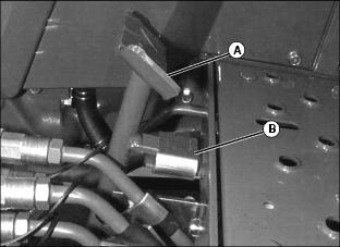

My new 790 came with a 'clip' to keep the clutch engaged for prolonged storage.
You could setup something similar or use a stick, clamp, visegrips, etc...
   / Stuck Clutch #3
A= clutch
B= clip

Thanks for the input. It looks like the clip will keep the clutch disengaged--right? You are right in that I should be able to rig something up myself that will do the job.
