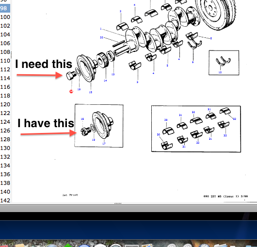

I have been trying to get the front loader mounted on my '59 MF65 for a while now. I am stuck with trying to get the hydraulic pump adapter plate mounted correctly.
The short story is that I finally broke down and ordered a new pulley (with the holes) and a new adapter plate (not bent), BUT my retaining bolt is too big - it is the "jaw" type for a receiving a hand crank. I need the flat version, but I cannot find anyone who carries these bolts.
Anyone have a solid lead for me to locate one? Pic below (snapped from AGCO manual):

I might have cracked the code ... I found a Perkins part number 32162316 - but the one I found listed in a parts catalog was $50. I am almost spending more on the connecting hardware than I did on the loader itself. ;-(
   / Stuck. Need a new perkins crankshaft pulley retaining bolt, cannot find one... #3
Do you have a Fastenal near..?? Maybe they can match you up with something.
If not, found one here for a lot less than $50.00. Jacks Small Engines Search
Note the superceded part number, if you want to look elsewhere.

Once more, DJ54, you save the day! :) Many, many thanks!

Trying to get this FEL mounted has been a real learning experience.
After spending $120 to get the drive rod machined, I didn't want to have to spend another $175+ for a new pulley and possibly adapter plate.
I did successfully drill and tap my pulley, and discovered that the adapter plate needs to sit down into a recess on the pulley, so I successfully milled my pulley with my mini-lathe (with 1/32" clearance - the pulley is basically the exact size of the maximum throw on my lathe!), and got my adapter plate set down into the pulley, and then found: 1. that the "jaw" bolt was too big, and 2. that my adapter plate seems to be bent - as it throws the rod in an elliptical - it doesn't spin true. UGH!
So I broke down Sunday night and ordered a new pulley and new adapter plate, and the bolt was the only missing piece of the puzzle that I hadn't cracked.
My thanks is understated, you really helped me out, and I am deeply grateful - it's like seeing that hand come down to help pull you up the bank after you just slogged 2 miles in a muddy creek bed. Or something like that. :)
My adapter plate arrives today, and I found a Fastenal in town (I didn't know was there), so I'll see if I can get by with my original/modified pulley. Maybe I can save $90 on this project, for a change.

Okay ... Fastenal helped me replace one of the missing front-end mounting bolts, but they crapped-out on the crank pulley bolt. The closest thing they had, which was 15mm longer than the original, was coming up at $44. I just placed my order with Jack's.

Jack's came through. Their bolt was a little too long, but I hacked it down to size, and I was in business.
I could just fit the pulley on my lathe, and was able to mill out the pocket to recess the pump drive adapter plate. I re-drilled the holes on my press, tapped 'em ... and then after reassembling the whole front end, and trying to test drive her, the rear pivot pin on the axle gimbal slid back and hit the bolt heads on the adapter plate.
I then discovered that the retaining plate on the front of the tractor that bolts into the front pivot pin, was not tight, because the bolts were not in all the way, and had become gored pretty badly. I re-tapped the holes, and ran a die over the bolts, and everything snugged up nice - AND not more slop.
Attached is a pic of her once I ran her around the yard, and then took the opportunity to show my oldest son how to drive her... we're all pretty new to this tractor thing. :)
Next step is mounting up the frontend loader! Should be a similar "roller coaster" experience.
