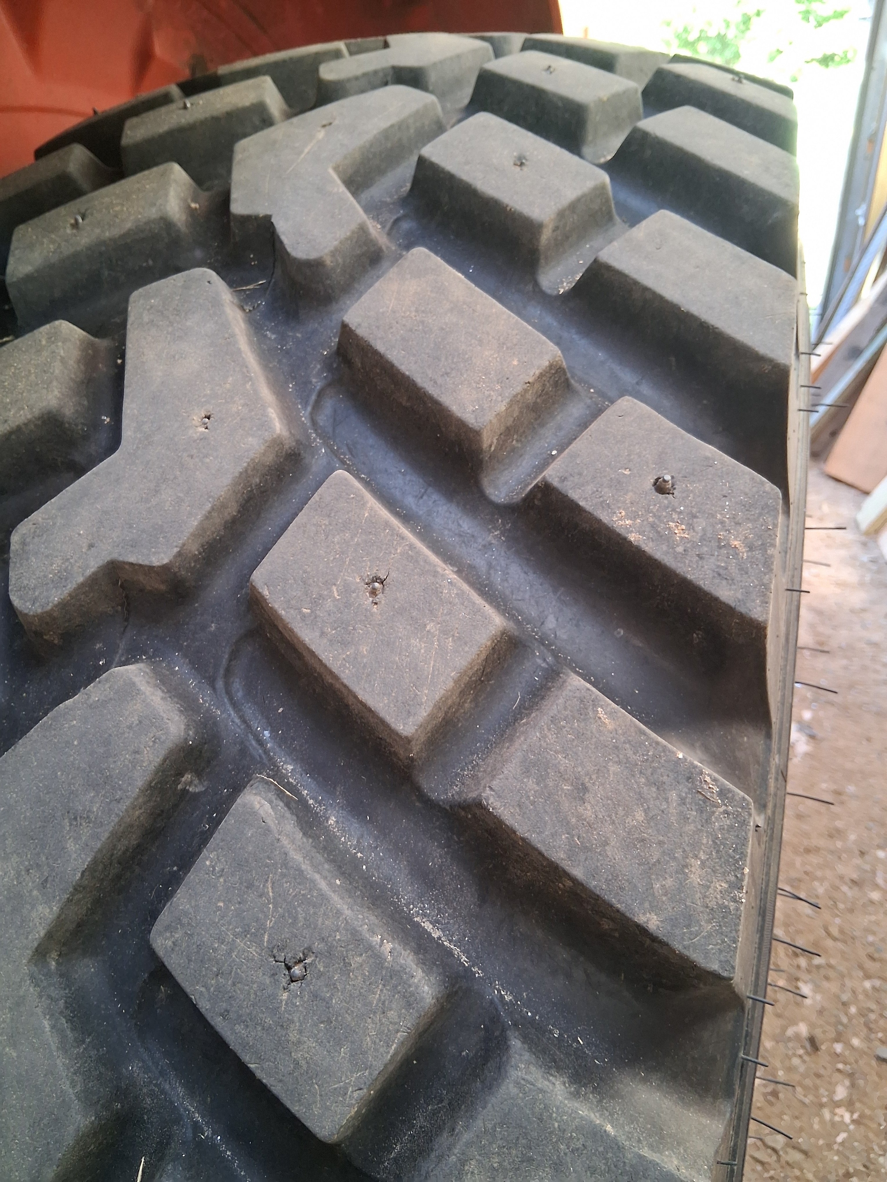

I swear by them. 👍
They'll never beat tire chains, but they make enough difference for me. These have been in the rear tires for 4-5 years, I leave them in as removal ruins that spot for re installation.
You can see that they're spaced in a pattern and there's not really that many of them compared to what it could be.
Some of these are in their 2nd set of tires while the balance were new. They're about a buck each, cheap enough but iirc there's around 200 in each rear !
Pretty good sized tire (18.4/r30 or 480/80r30 metric) for your comparison
