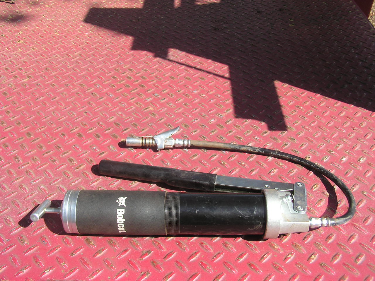

I also have the Lock and Lube and think it is worth the high price. you can get it with free shipping direct from: LocknLube grease gun coupler ends greasing frustration.
Here are the other threads here on TByN: http://www.tractorbynet.com/forums/oil-fuel-lubricants/304889-locknlube-cupler-grease-gun.html and http://www.tractorbynet.com/forums/owning-operating/307933-review-locknlube-grease-gun-coupler.html
Mine is on a high pressure lever gun with a hose, instead of the usual pipe, that makes it the best combination to get to the hard to reach zerks.

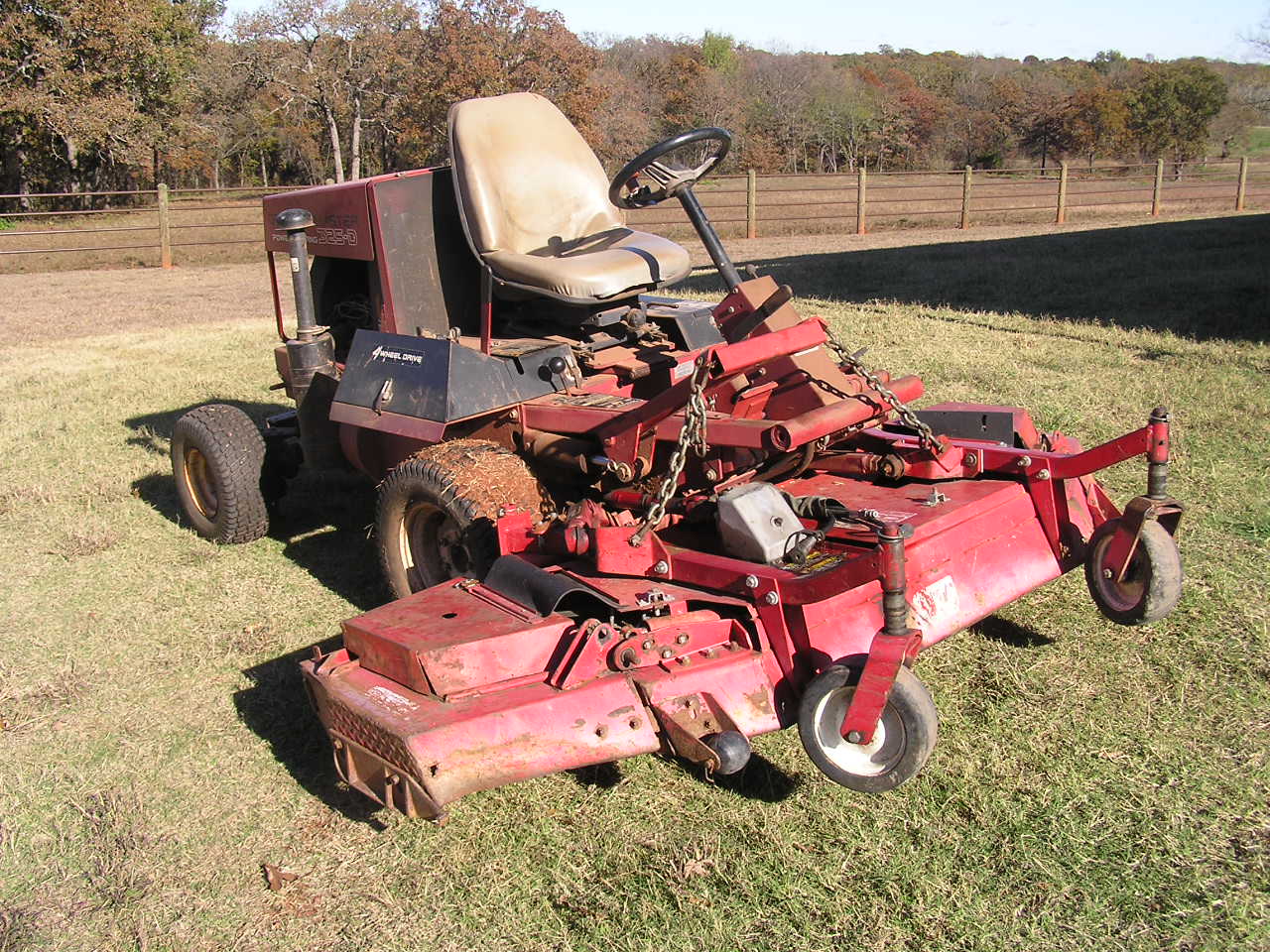

I don't understand why you say you need to to hold the coupler? That is the advantage of the Lock and Lube, put it on the zerk, then one hand on the gun and the other on the lever.
Or sometimes two hands on the lever and the gun against my chest, for the ones that are hard to grease!
That is why I put mine on a hose, instead of the tube. Makes it easy to grease the wheel hubs on the mower deck, just lift it, rotate the wheel and lock it on.

My comment applies only until the coupler is locked on the zerk. My point was that you can't just snap this style coupler over the zerk by just pushing, like you can with a conventional coupler on a rigid tube. But once it's on, you can use both hands to work a lever-type gun, even with a flexible hose between the gun and coupling.
The thing I like most about this coupler is that no grease ever escapes around the zerk. I have several zerks that usually required more than one attempt to get a good connection with a conventional coupler. And every failed attempt produced a big glob of grease around the zerk.
