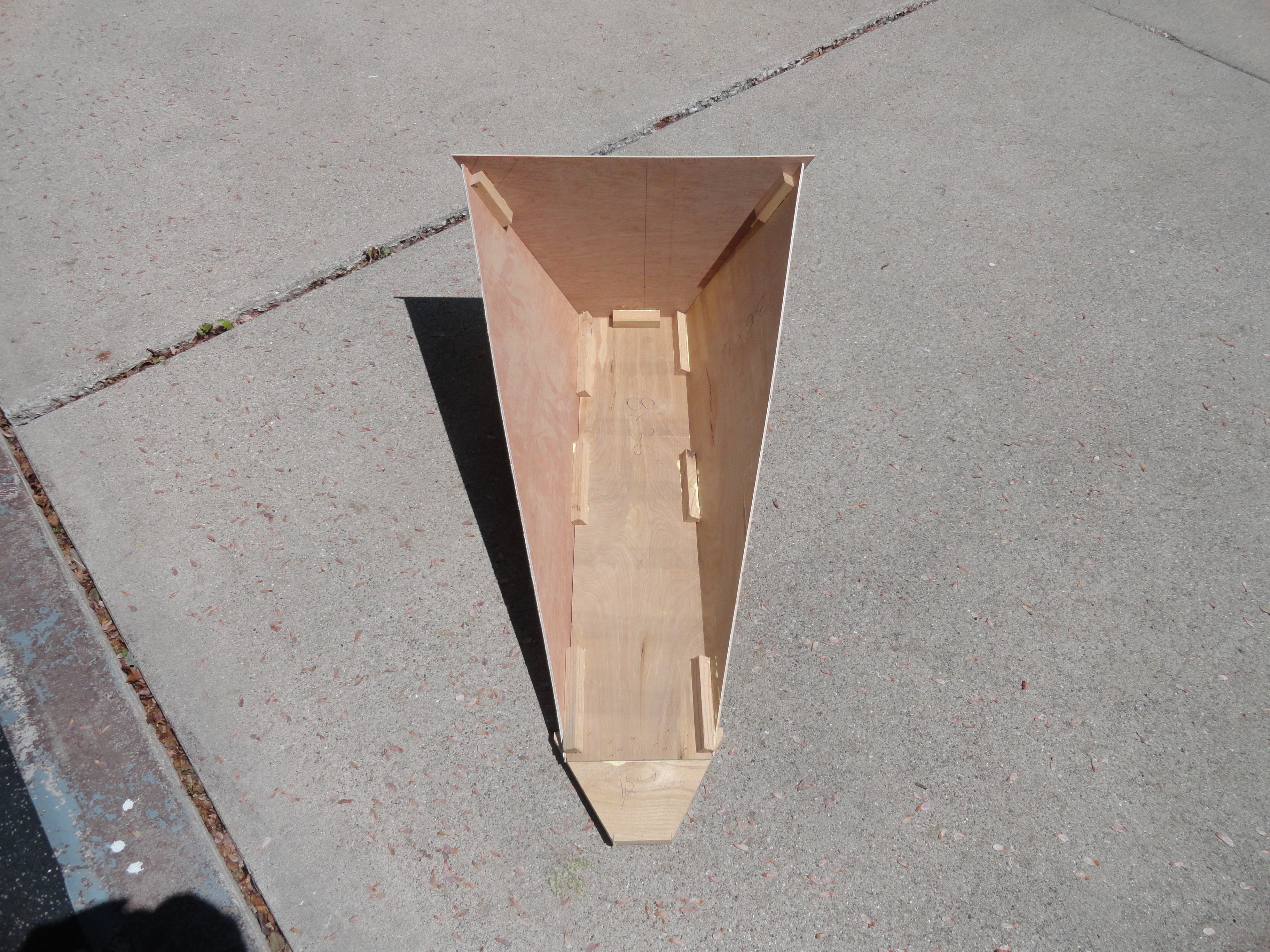

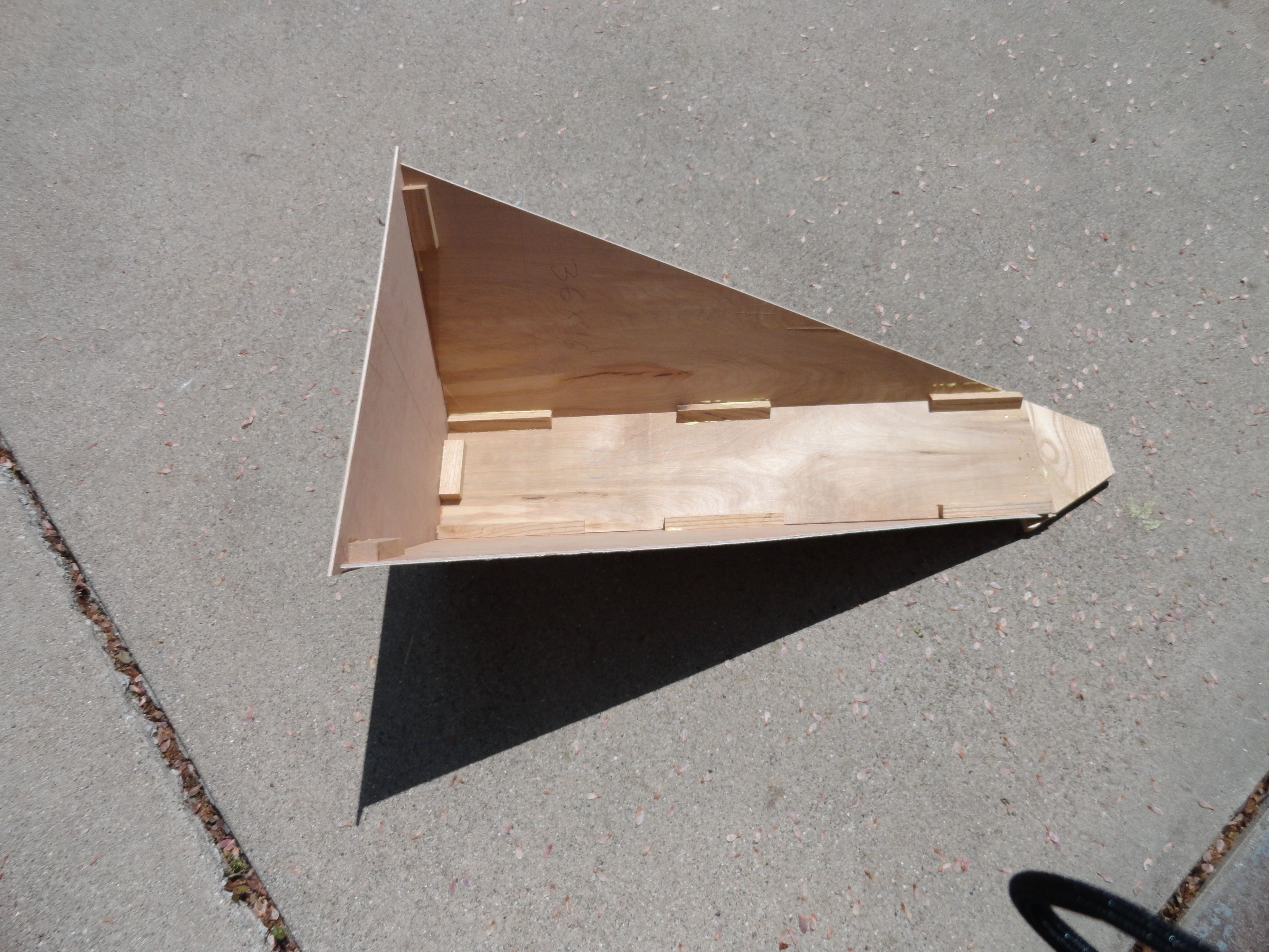

I have a Bobcat CT225 (Kioti CK27) tractor and I want to build a stump bucket for it. I have attached pictures of my mock up.
All metal is 1/4" except for the front edge - it will be 1/2"
Bottom is 8" x 36"
Sides are 16" x 36"
Angle of sides to back is 30 degrees
I will have 2 each 8x8 supports on the side of the bucket
Any thoughts or suggestions?
Thanks

Thanks, I did see the thread and OP has been very helpful. I am wondering if the angle to the back plate should be different based on my tractor HP.

That Titan bucket looks like a great deal,, usually, for a DIY, the backing plate alone would cost over $125.
How thick is the bucket material on the Titan bucket?
   / Stump Bucket Build - Suggestions and Ideas
1/4" - the end has a 1/2" plate welded to it
