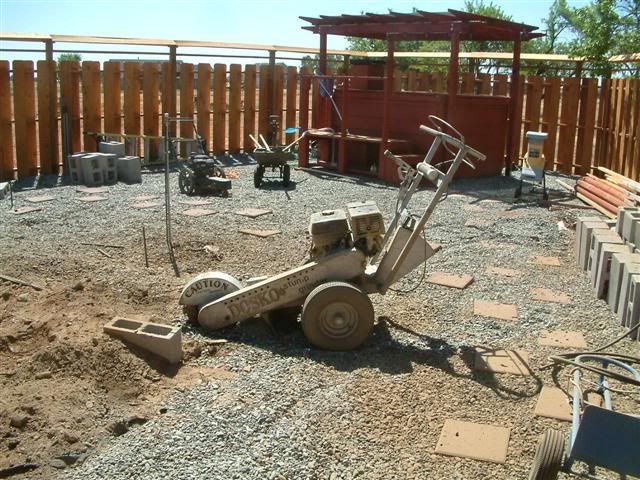

That Vermeer is a nice unit, a lot nicer than the basic grinder I rented a few months ago to grind down a half dozen almond stumps
Most of these stumps were 8-12 " dia, but one was about 2-ft dia.
Didn't take long to learn to use the grinder effectively. The smaller stumps ground down to about 6" below grade in less than 5 minutes. The big stump took about 30 minutes.
Just be sure that the grinder you're renting has a good strong battery so you can restart quickly after the thing stalls (and it will stall, guarenteed). I suggest starting and stopping the unit several times at the rental place before hauling it to your jobsite just to be sure you don't get delayed by something stupid like not restarting easily.
100 per day? Sounds like a long day to me. My guess would be 3-4 days, but I'm an old geezer who gets tired out quickly.
