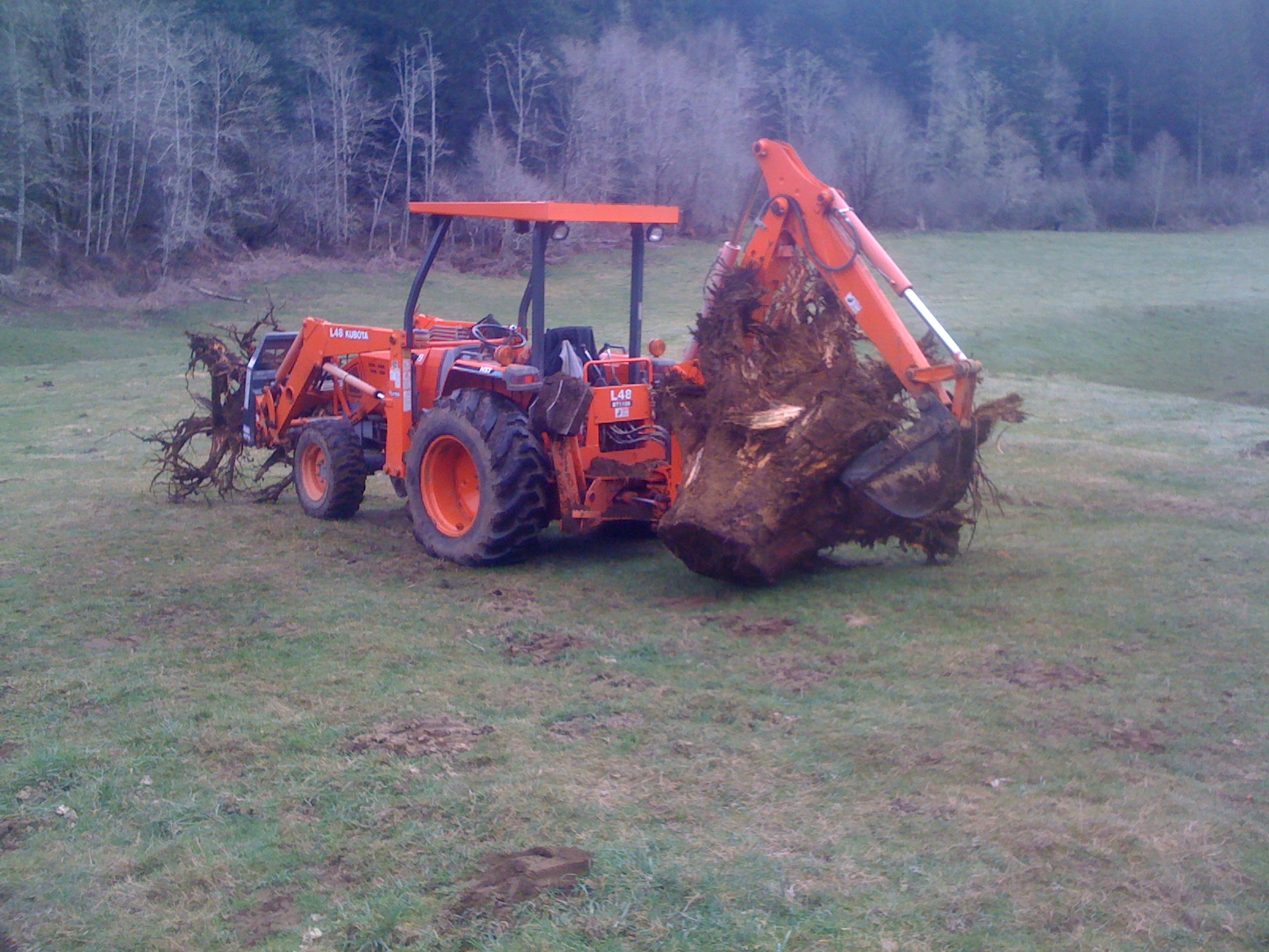

Backhoes are pretty versatile and while maybe not the best tool for stumps they get that job and many others done fine. Rick
