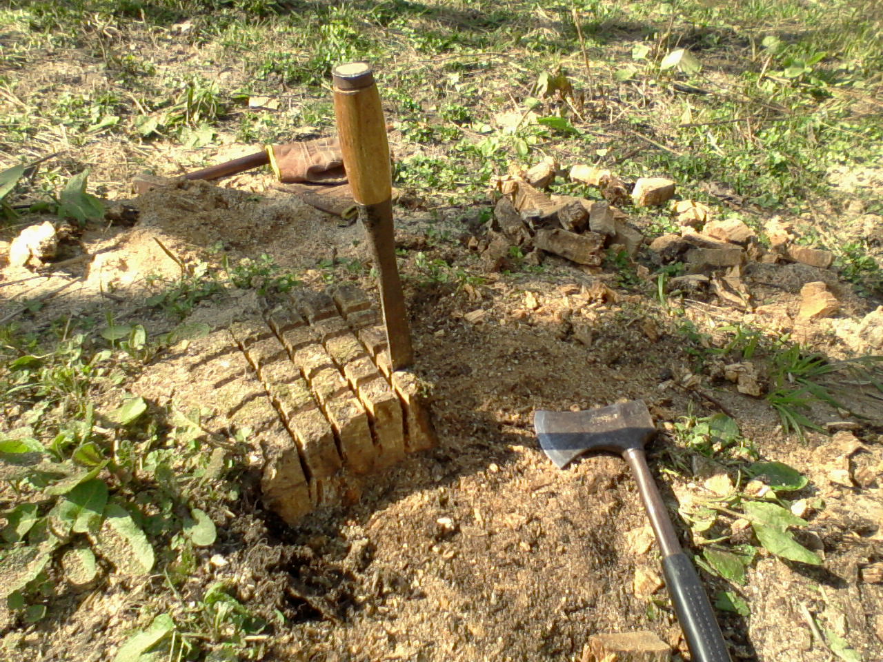

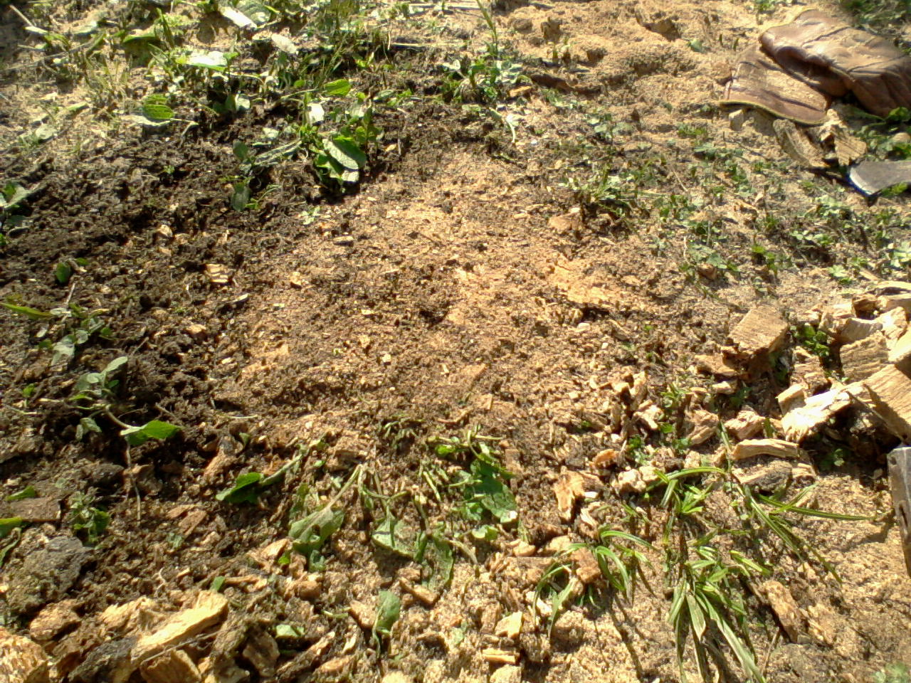

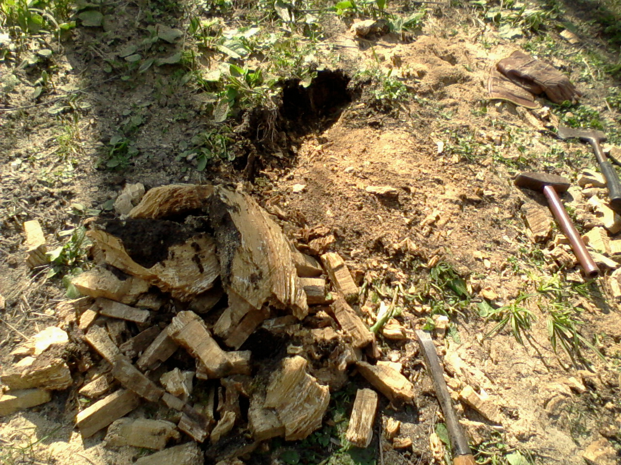

Used the following stump removal method (pics below). It's not mine, seen it somewhere, probably in TBN.
The stumps are wet but not rotted off. Method works great, I have removed 27 stumps within 1 day.

I'm sure all the methods you fellows have mentioned are really effective. But my case was of a very small span. Just 27 stumps in an area of 0.12 ac. That forest clearing was dedicated just for walking before. From now it'll be used for driving too. Before I was mulching it with a flail mower, from now I'll use a lawn mower. The task was to remove obstacles so next day I'd be able to mow a grass. Not waiting to rot the stumps away, not trenching the soil to remove the stump roots, not wasting time and extra fuel $ (~ $40) to get to the town to rent a grinder, etc.
But I admire your guys desire to mechanize any kind of job you're in! :thumbsup::) Here we sometimes say: "How would you solve an issue if you'd be an American?" It means - try to work with your head smarter than manually. And don't forget to employ machines :laughing:.
