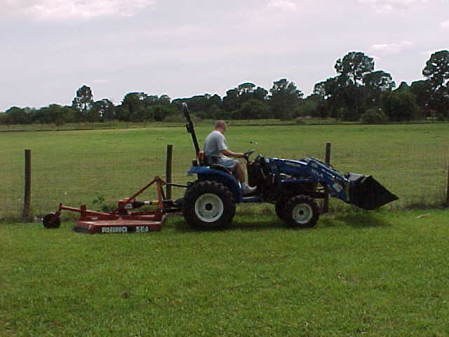

Brad, hooking it up is quite easy, almost intuitive. The PTO shaft just slides onto the output shaft until it clicks.
Now, UNhooking it for the first time, especially if you were not the one hooking it up, was a different question for me. My TC18 was delived with the rotary cutter already hooked up, so it was easy to unload. The fellow from the dealership went over everything we could think of on how to operate the tractor. He stuck around until both my son-in-law and I had a chance to try everything and were fairly confident. After he left, we decided to try to box blade.
I'm embarrassed to say that the one question I didn't ask was how to unhook the PTO shaft. We looked everywhere, and just couldn't figure it out. Finally, Doug beeped a friend with a tractor (Nextel Direct Connect is wonderful), and he said to "push the button." Turns out the release button coincidentally ended up on the bottom of the shaft when it stopped, and we just never saw it. We're going to be a long time living that one down...
The only other thing you'll have to figure out to get started is how to adjust the cutting height. Adjust the rear wheel(s) to the height you want, then lower the 3PH so the front is slightly lower than the back, then loosen, move and tighten the set screw stop on the 3PH lever so it will stop in that position every time you lift and lower it. Helps to mark that spot so you can set it up easily the next time.
Attachment is Doug's very first time moving the brush hog - within an hour he had it mastered to the point he was comfortable. We still have a ways to go to be expert...
