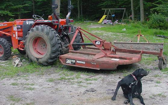

With my rotary cutter I set the front height of the deck using the position control on the tree point hitch. So yes it is ok to do that. I've been doing like that for years. Attached is a pic of my cutter hooked up to the tractor.
As for the tiller I only use the position control on the end of the run so I don't leave a gouge mark at the end. I gradually lift the three point hitch for the last couple of feet of tilling. But when tilling I generally put the position control in the float position and let the tiller run it's own depth until the end of a run. At times you might not want a deep till so you could use the position control to hold the tiller up so you only cut an inch or two.

I'd reckon that without the tailwheel (I don't have one) you'd get a lot of bouncing with the cutter up off the ground like that??
   / Stupid Question #7
The weight of the implement hanging on the 3pt is not the problem. The problem is in the shock from the weight of that implement bouncing up and down on the hitch. Thats where metal eventually fatigues leading to a possible failure.
   / Stupid Question #8
You don't have one,,,A rotary cutter or slasher down your way or a tailwheel on your rotary cutter??/w3tcompact/icons/smile.gif

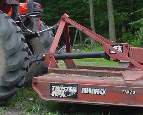

But yes it just rides on the single tailwheel. The toplink has a pivot so it keeps the bouncing down to a minimum. Take a look at a close up of the toplink hookup.

I guess I'd better point out that I don't drive at high speeds across bumpy fields this way! Actually, I don't drive at high speeds over bumpy ground with the mower down on the caster wheels either. Common sense does apply here!
