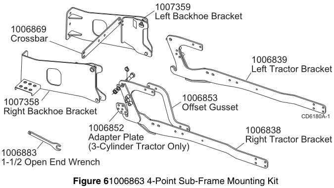

can anyone tell me were to get measurements for sub frame for backhoe attachment for kubota l 3130. purchased the unit about four months ago it has front loader assembly, also front mount snow blower came with it , i recently
purchased LW 6 backhoe attachment for it, also is it possible to operate the backhoe from the tractor seat, as i don't like the setup of having two seats

Here is a drawing of the Woods backhoe subframe taken from the Woods manual. You can download the complete manual from Woods site. Not sure about the dimensions but looking at the drawing should give you an idea of the mount points on your L3130.

yes this is the type of frame i am looking for shouldn't have any problems fabricating this frame. thanks for the reply much appreciated, when i get it fabricated i will post some pictures

Bambie,
I just noticed you have your subframe built. Hope you do not mind me linking your pictures on this thread. You did a great job... congratulations :thumbsup:.
