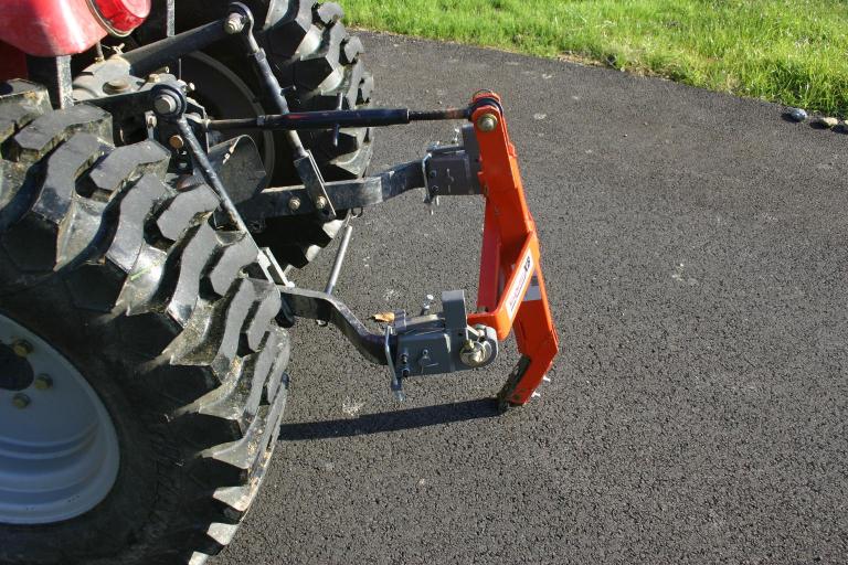

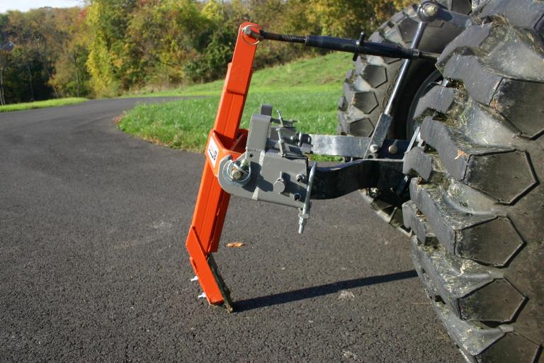

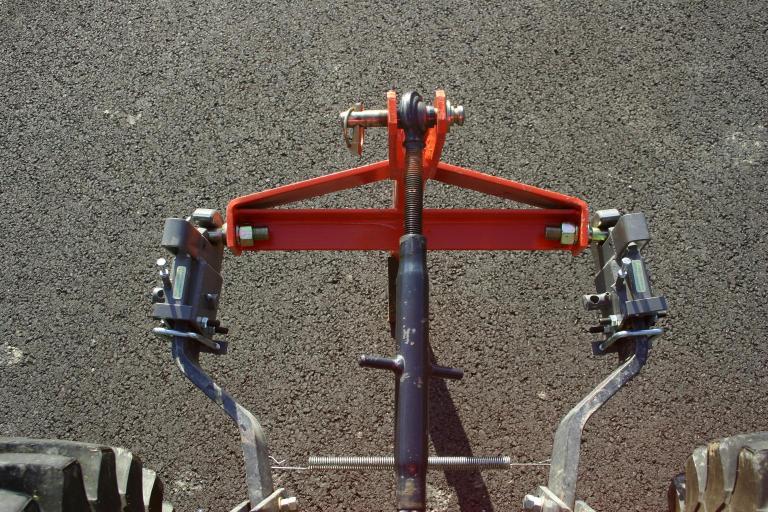

I bought a King Kutter XB Middle Buster/Sub-Soiler. I just tried it out and it just skips across the top of the ground. I didn't attach the furrower and perhaps that's the problem. I also just recently got a pair of the Pats Easy Change connectors which push the Middle Buster further out. I can't get it to be vertical with the top link I have. I know I'm doing something wrong.

I have a KK Middle Buster. I too have problems with the sub soil attachment. I found it works better if i dont put the 3pth in float. A little weight would help. The 14" plow actually pulls itself into the ground.
   / sub soiler not digging in #3
You may have to buy a different (longer) toplink. My initial suggestion was going to be to lengthen your toplink. As you are already as long as you can go, then my next suggested solution is a longer toplink.
   / sub soiler not digging in #4
An even better solution would to be sell the Pat's and get a quick hitch from Harbor Freight. That will set your top link out even with the bottom, and you'll be able to extend it far enough to get the subsoiler to dig in.

I'm still trying to figure out the Pat's. Yesterday I also got a RFM and noticed that it had popped out of the hitch too. So far I don't have the warm and fuzzies about this solution.

The XB equipment is made for sub compact tractors. I don't think yours is a subby.... That might have something to do with it.. Just a thought.

Dang - you're right. There's nothing on the TSC site and I didn't notice that the link on KK site said "sub compact products". I was going to post yesterday that the sub soiler looked a bit too small. Well, it's going back.
