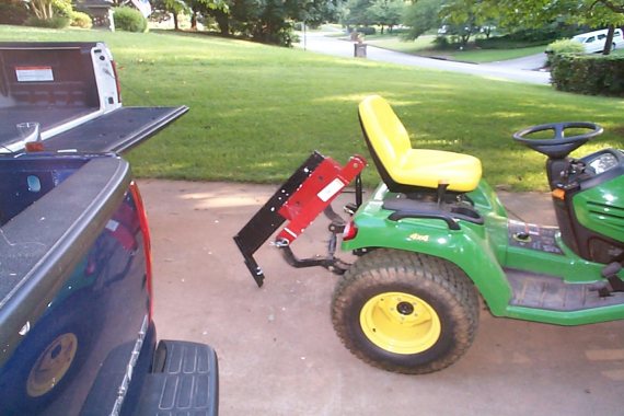

I purchased a subsoiler from howse implement for my x-575.
I had to take it to a machine shop for some minor alterations
but it went down 11 inches in some areas after several passes.
good luck
