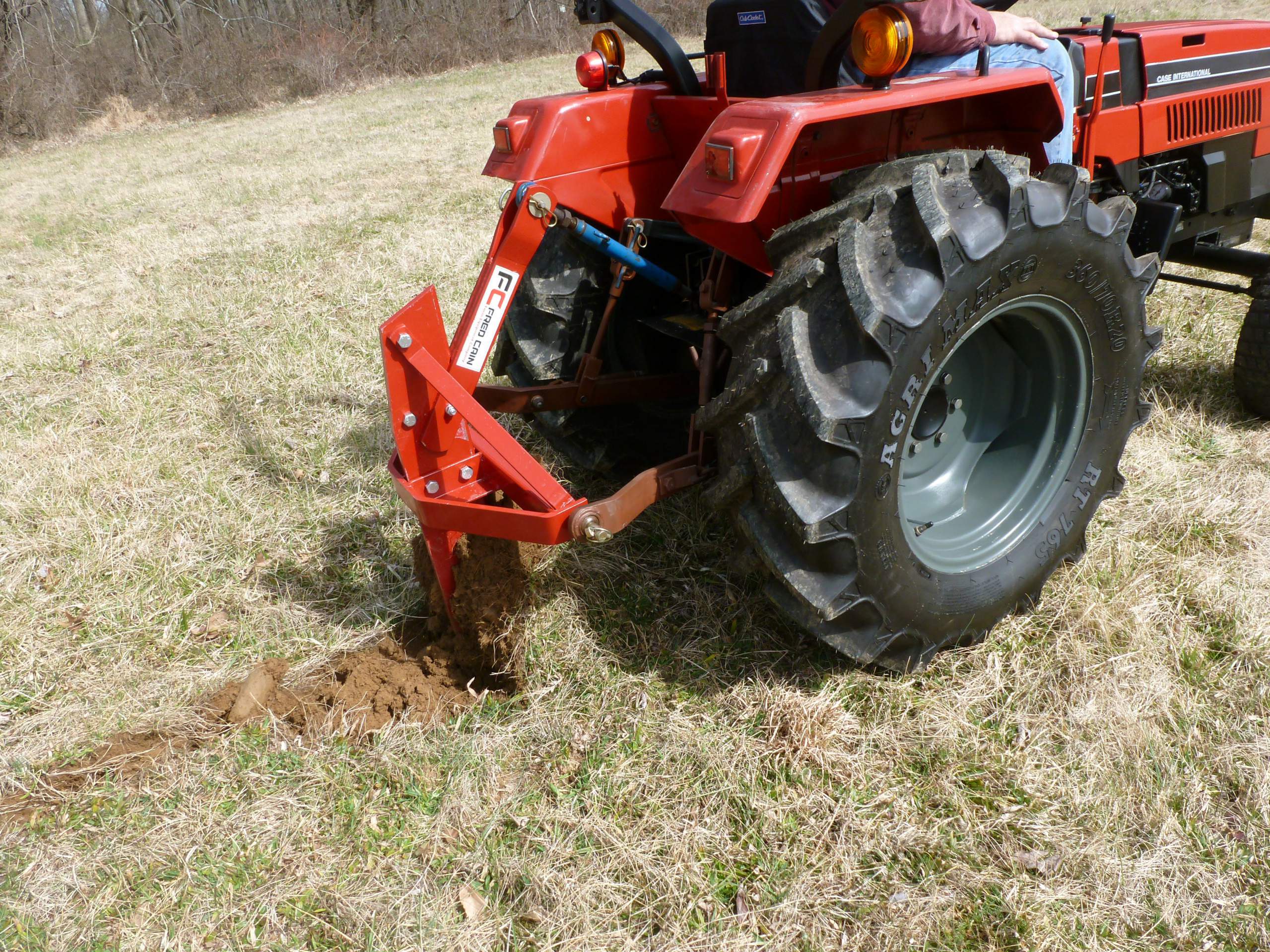

Pulling a subsoiler is fun, though it will likely stop your tractor a few times, particularly in the stuff you are describing. You might need two passes. Local farmers use them to drain standing water areas off their fields.

I really like those rear tires. They're like a R1 and a half!
   / sub soiler ??? #9
thanks, yeah, the tractor is a bit overtired, but that was my best solution for going R1 without having to buy new rims. In order to get the diameter, I had to go to a much wider tire, and boy do they work nicely. And they fit ok too, because the oem tires were the wide Bridgestone Pillow turf tires. Took a lot of research to find this size tire, and I am very happy with BKT, which is basically the Goodyear of India. Nice soft ride too. Since the tractor only weighs one ton, and a little, they make for serious flotation also, not going to get this thing stuck anytime soon. I hope...
I subsoiled a 5000 sqft patch of fallow field that was full of rocks. The garden drained very nicely after that, aided by a bit of natural pitch anyway. Many times the tractor would just stop, slowly spinning even these big tires. Amazing what 23hp and decent gearing will do. I can't wait to try this subsoiler on my larger tractor, which it is better sized for.
btw, these tires were brand new in the pic, I couldn't wait to get them in the dirt.
