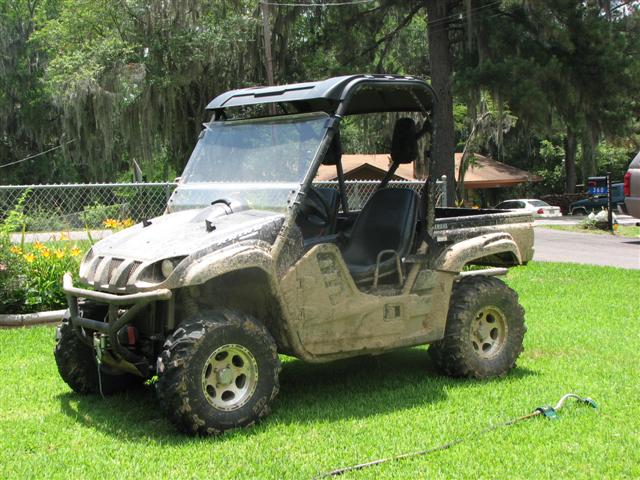

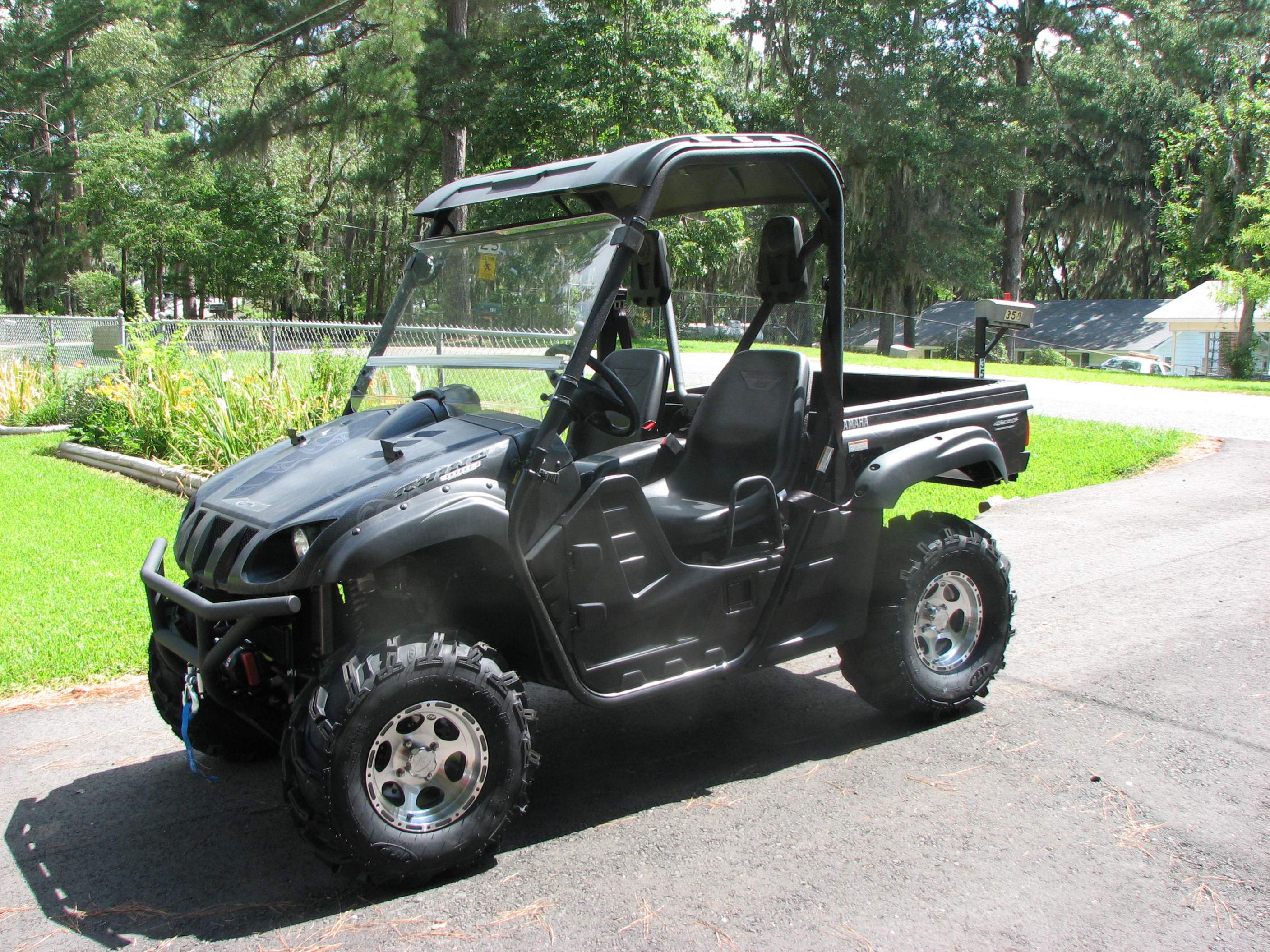

One of the most trouble free is the Yamaha Rhino. Here is a picture of mine. It should do what you need with very little trouble.
