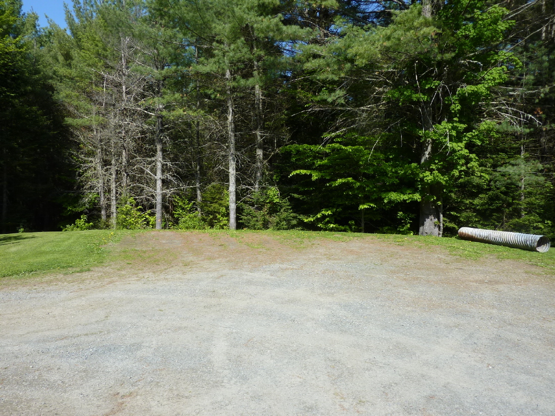

Mikesen,

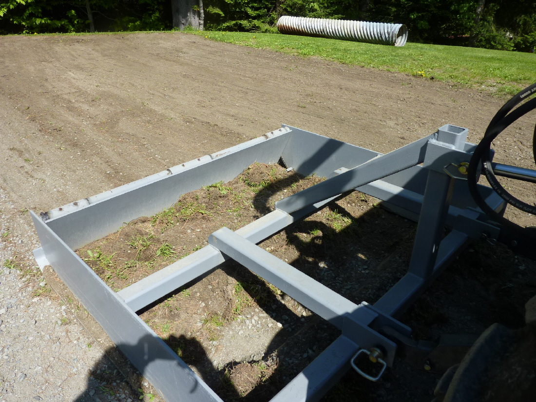

Here is some sod I removed just so you can see. BTW - Welcome to TBN
Starting out it looked like this

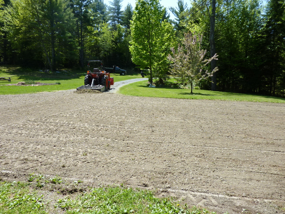

Here is what happens. My tailgate collects the sod. If I didn't have the tailgate the sod would just pass thru with the gravel.
Finished job
