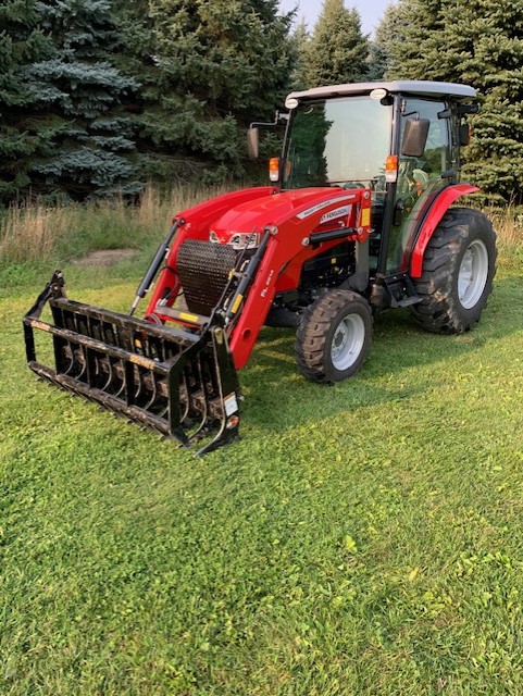

I have a 2850M with a land pride sgc1072 with a MF one button diverter valve system piped in on the front of the loader, similar sized tractor to yours. It weighs in at 450lbs and is very rugged, land pride grapple in built with high strength steel where others may not, check specs. I love it. I also as previous poster made a grill guard to protect the front end but remember nothing is full proof I found if I only move forward in a shorter motion I知 less likely to have debris close in on the front of my tractor still acquiring a full load. I too found a sgc1572 on Craigslist but I thought the extra 400 lbs would definitely effect the working capabilities of the grapple and went with the 1072 instead.
   / Suggestions Grapple for 1700M Series #6
MF 2850m with Land Pride SGC1072 and fabricated grill guard made from thin diamond plate steel. Brush sticks branches etc. have to go around to contact grill although there still a threat, so far so good

Thanks all for the replies. I highly agree on the Grill Guard suggestion after having to learn the hard way years back on a Branson I had. Need to install a guard on my 1755m. You said 450lbs for a sgc1072 which sounds good to me so as to not lose too much lifting capacity. I was thinking about a 60". I'm also leaning towards a Diverter valve vs a 3rd function due to cost, easier install and the ability to feather it open/close. Any opinions on a Summit Diverter value? Thanks again & Merry Christmas all!
