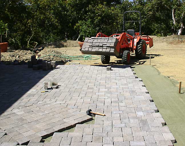

Depends a lot on the looks you want. I went with a colored and tumbled (antique) paver for several patios around the house. The total cost was around $2.20/sq. ft. not counting labor. In this area, plain concrete runs around $3 to $4/sq. ft. for a similarly sized project and I couldn't have done it myself.
Looking back on the project... it wasn't really that hard to do ourselves and looks great. It took 18 pallets of pavers, so my tractor came in handy as a giant wheelbarrow to bring them around the house to the back.
Three new pairs of leather gloves and quite a few hot soaking baths should be added to the total cost.
The picture was taken before they were filled and compacted.
