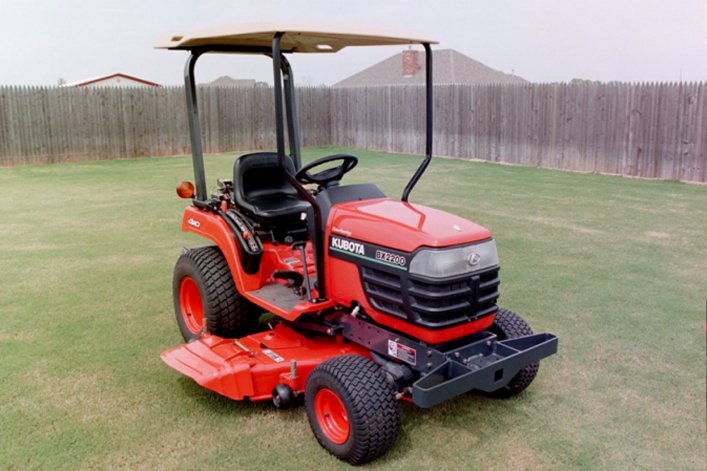

I bought suit case weights from my dealer. Bad part was, he only had green (JD) weights in stock. I then built a mounting bracket for the front of the tractor (BX 2200) that also acts like a bumper as well as a reciever hitch. (see attachment)

Will the bumper have to be removed if you wanted to add an FEL?
