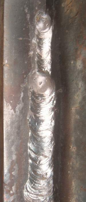

You give some good advice here. Thermal now makes a good all in one machine. The Miller multimatic is nice but heavy and expensive. I also have a Maxstar 150 and I will agree about being impressive, 1/8 6011 and 3/32 7018 toasty on common 120V circuits. I don't use field mig for a couple of reasons but the Max has about retired my engine drives. Its not really a 1/7018 on 120 machine, some circuits will tolerate it but you got to keep it turned down a pinch or will trip a 20. I have had it on 200 ft of 12 thru a barn, even with 3/32 will droop enough to trip if you have it hot. I welded up a bunch of mobile home beams in a storage building with one, not a problem.
Did a field repair on a forklift, used supplied 120 and only weld that had to be heavy on the job was one vertical about 6 inches long, the added time to run another pass over it was moot.
I built a 300-foot, 10-gage extension cable and a custom cable reel. I have it setup so that I have pigtails for 110 or 220 VAC so I can run the MaxxStar from either power source. On 120 VAC the voltage drop over the cable is about 3 Volts.
I loaned the extension cable to the machine shop along with the MaxxStar when they were welding the crane support system - that probably helped with the welder's performance.
