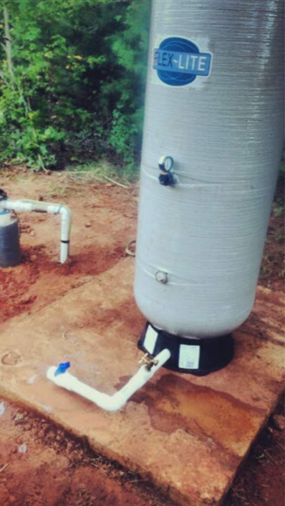

Howdy all,
I had a 700' deep well drilled for our new home last September. The well sat there and didn't really run at all until we moved into the house this past April.
After being in the house about two weeks, we started to notice that wonderfully aromatic smell of sulfur / rotten eggs. Specifically when we would take showers.
Now, I have read all about well water becoming stinky from the hot water heaters. So before you reply that I should start here, let me finish...
We have a tankless, on-demand Rinnai hot water heater. (Propane fired) Most places that I have read about the rotten egg smell coming from a traditional hot water heater have said that a fix would be to install a tankless system. That's clearly not a fix for us.
My gut is telling me that it's from bacteria that developed in the well from Sept 2013 until April 2014 when we moved in? We did use the water from the well sparsely during the construction of the home. Maybe a good chlorine shot would help?
Let me know if any of you have some creative thoughts here. We do notice the smell the most using the hot water, but it is also present in the cold water, too. Just not as strong it seems.

I notice they didn't test for sulfur. Hydrogen sulfide (H2S) is very common in deep wells. Sulfur and Oxygen share the same valence, so H2O and H2S often come out of the same hole. Fortunately, H2S is very volatile, and will evaporate given the chance. A pitcher of water in the refrigerator will often lose the sulfur smell by the time it is chilled. It can be removed from household water by just running a sprinkler inside a large tank, with a fan to change the air. Don't bother to treat what goes on the garden, it won't hurt the plants.
You can try shocking the well with bleach, but it probably won't work.

Thanks for the advice, Larry. That was the 2nd thought I had - to use an external tank to vent any gasses. I had already been thinking of setting up a 2500 gallon tank as a "back up" to have water if we lost electricity, anyway. I guess this could accomplish two things at once now - venting gasses and having a back up!

Do you have a bladder tank or a air to water tank. I had my well drilled 2 months ago and put a water to air tank die that they let smell out of water and into air and when pump comes on it pumps replacement air in so you air exchange to help with odor.
   / Sulfur / Rotten Egg Smell in New Deep Well
I do, actually. It's an 80 gallon pressure tank. Maybe there's something wrong with that?
   / Sulfur / Rotten Egg Smell in New Deep Well #8
What color is your tank.
Blue = rubber bladder - no water to air
Galvanized = air to water
Gray = water to air but glass lined
#9
What color is your tank. Blue = rubber bladder - no water to air Galvanized = air to water Gray = water to air but glass lined
It's gray. Here's an older pic.
   / Sulfur / Rotten Egg Smell in New Deep Well #10
That's an air to water tank so changing it won't help. That about all I can think of.
