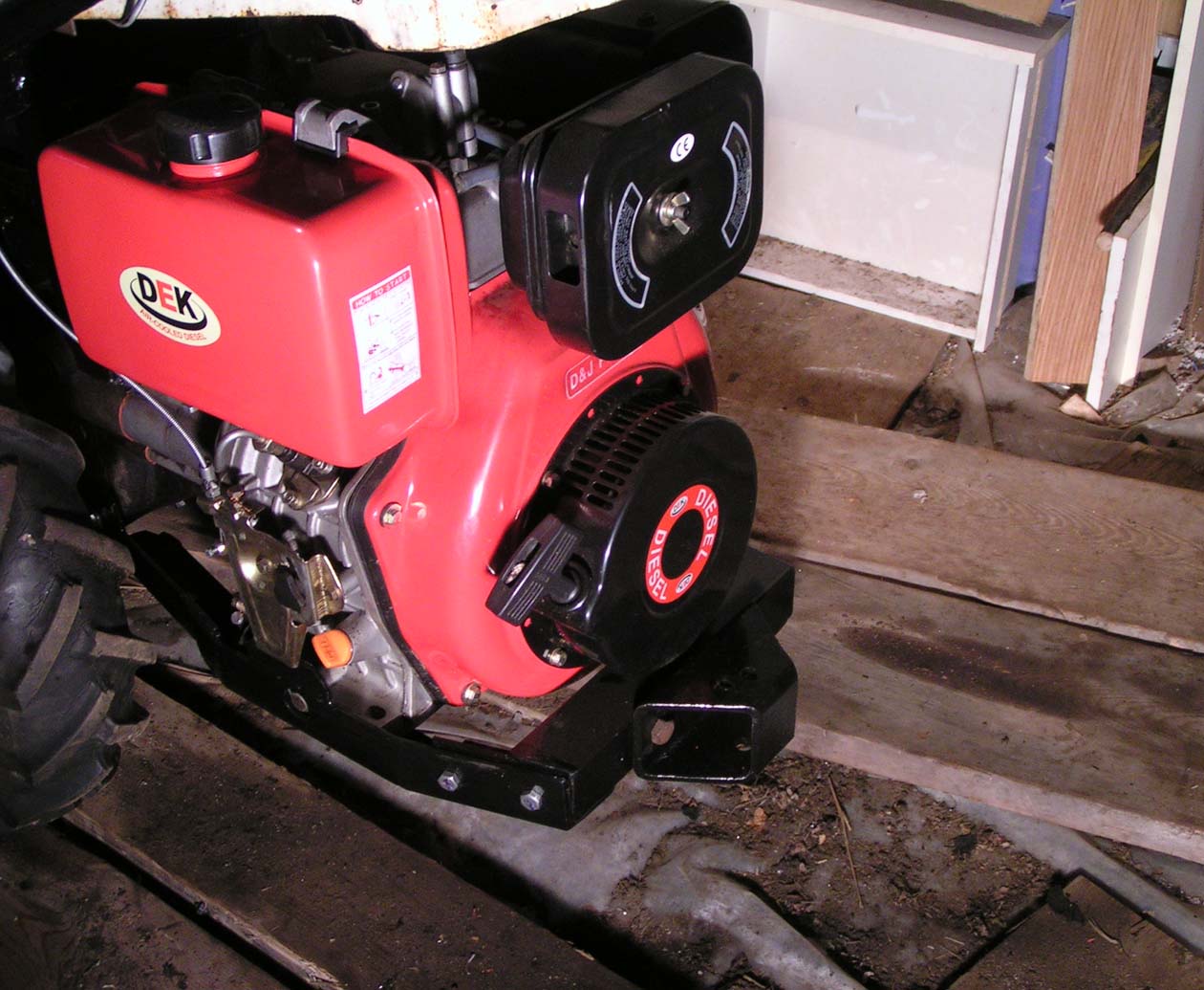

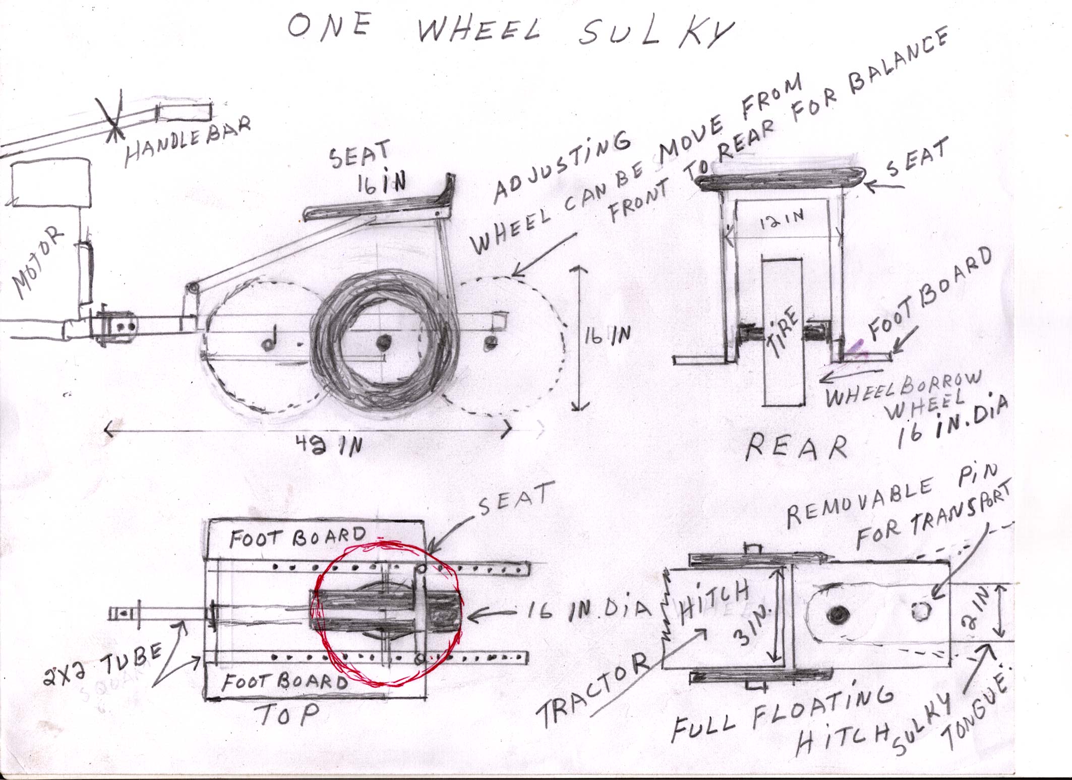

Hi! I fix a subframe and a hitch at my Gravely diesel. Now I want a sulky. I make a pencil draw for ONE WHEEL SULKY. I want your advice. Thanks! Oldmech
   / Sulky question #6
Oldmech- Look good ! I can't wait to see pics of the velke when it's done. - Kris :)
