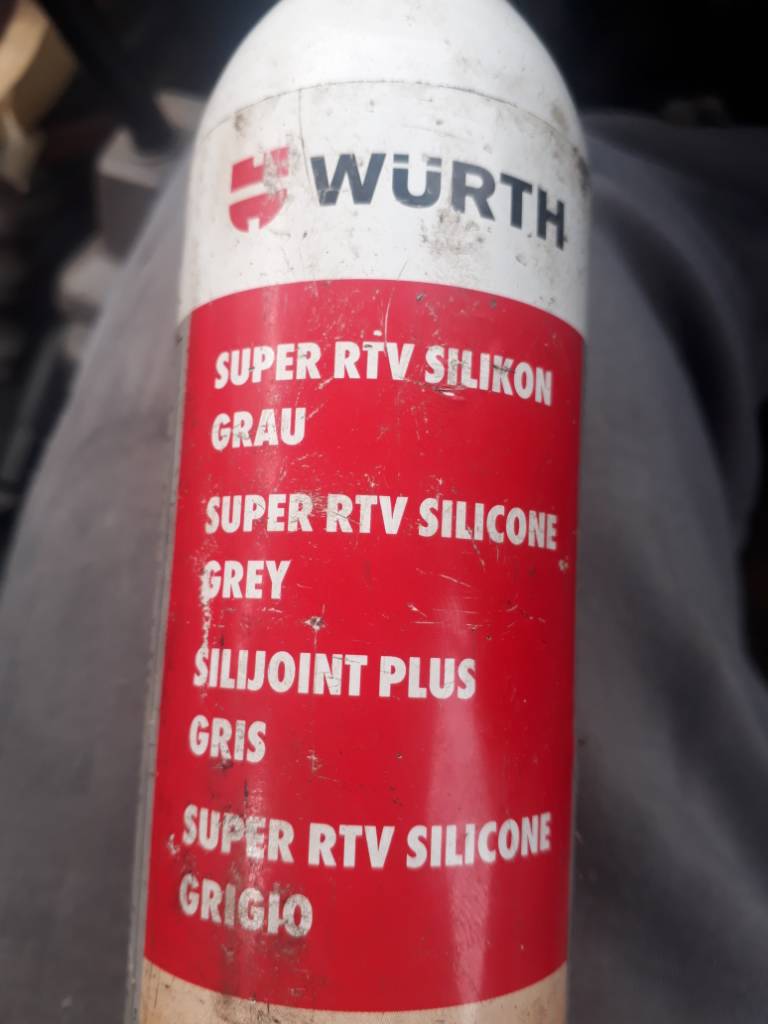

Having made a replacement gasket out of a hard gasket material while I have been sorting out my tractor, I now have a small leak from the sump gasket, would cork be a better alternative to the gasket material used previously? or what would be a good option, the original was a soft type material.
Chris
   / Sump gasket material, Iseki TX2160 making a replacement #2

I've had success on rear differential covers with orange high temp silicone. Lay an even bead over the whole flange and let it skin over for about 20-30 minutes. Then assemble.
Thanks I will see what we have here in the UK, ditch the gasket and apply it as you say.
