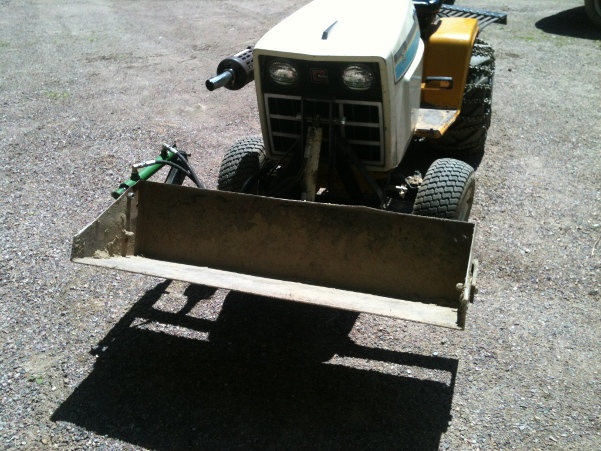

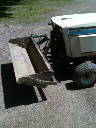

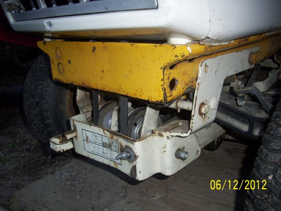

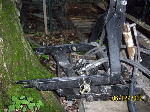

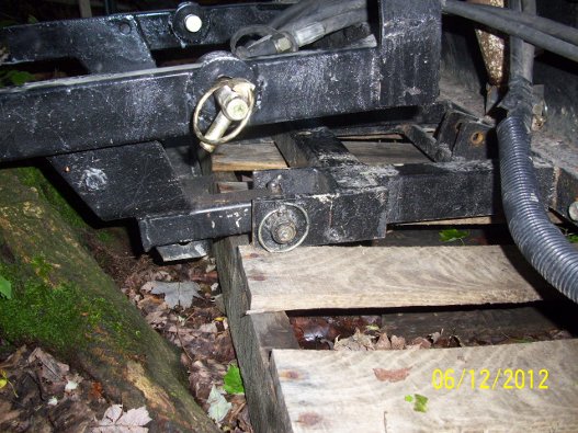

Here you are. The bucket is basically 42 inches wide and it is set up to use the hydraulic valves already on the tractor. The Cub cadet 1512 has both a front hydraulic port and a hydraulic to lift for mower deck. I tied into these lines which gives me the lift and dump on the bucket. Will lift close to 200 lbs and has power down (will lift front wheels). The set up uses a mule drive from a mower to create an front attachment point. There were no additional holes drilled into the tractor. Will try to get few better pictures of the mount.
