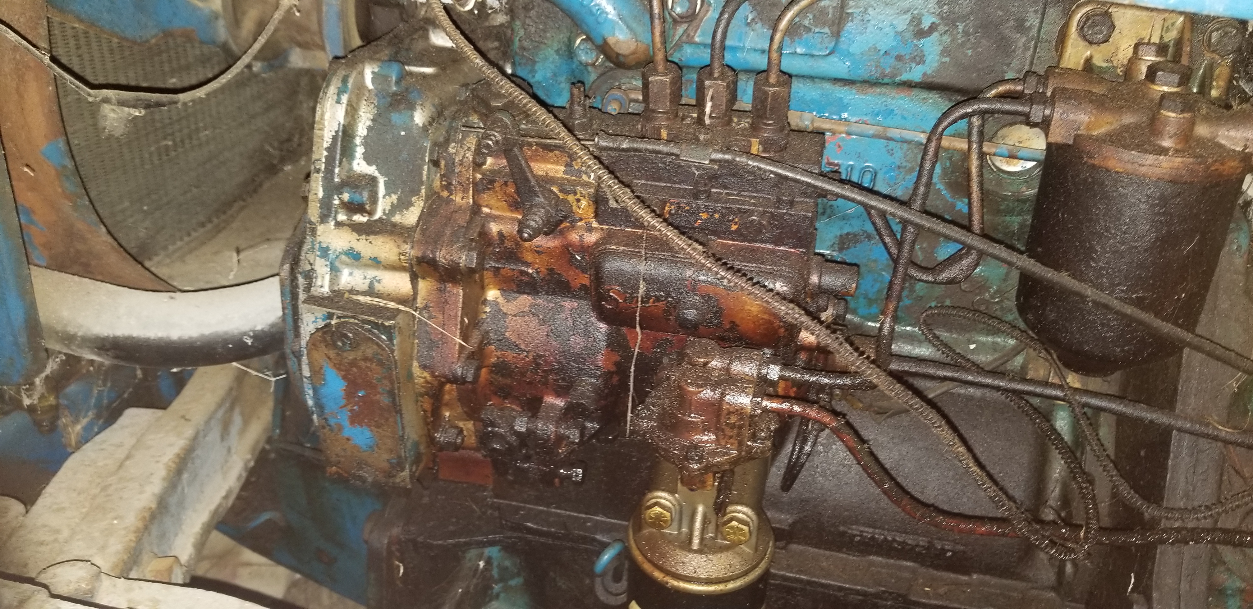

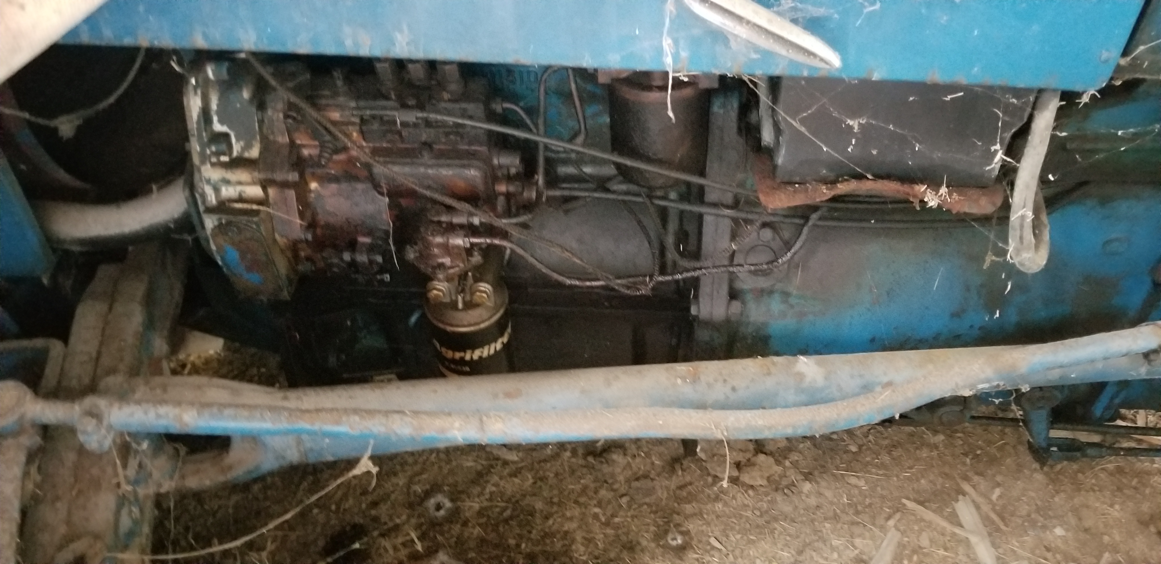

I had to fix my throttle linkage at the injector pump and removed the injector pump without following any procedures. Now the tractor isn't running properly. Any suggestions on how to re-time?

   / Super Dexta With Perkins 3 cylinder Diesel #5
Is it possible to post a pic of the pump & side of engine.??
   / Super Dexta With Perkins 3 cylinder Diesel #7
Theres a timing mark on the pump drive hub..
I've never installed 1 of "those" pumps to an engine, so I cant tell u what your looking for on that part..
BUT I would assume u have to find #1 compression stroke on the engine & then line up the timing line on the pump..??
Did "U" replace the throttle shaft.?? or did u take it to a shop.??
I would remove the side cover on the pump to determine which cylinder they're using for #1..
It "looks like" they might be using that blanking cover as a timing cover.?? {in front of pump}
