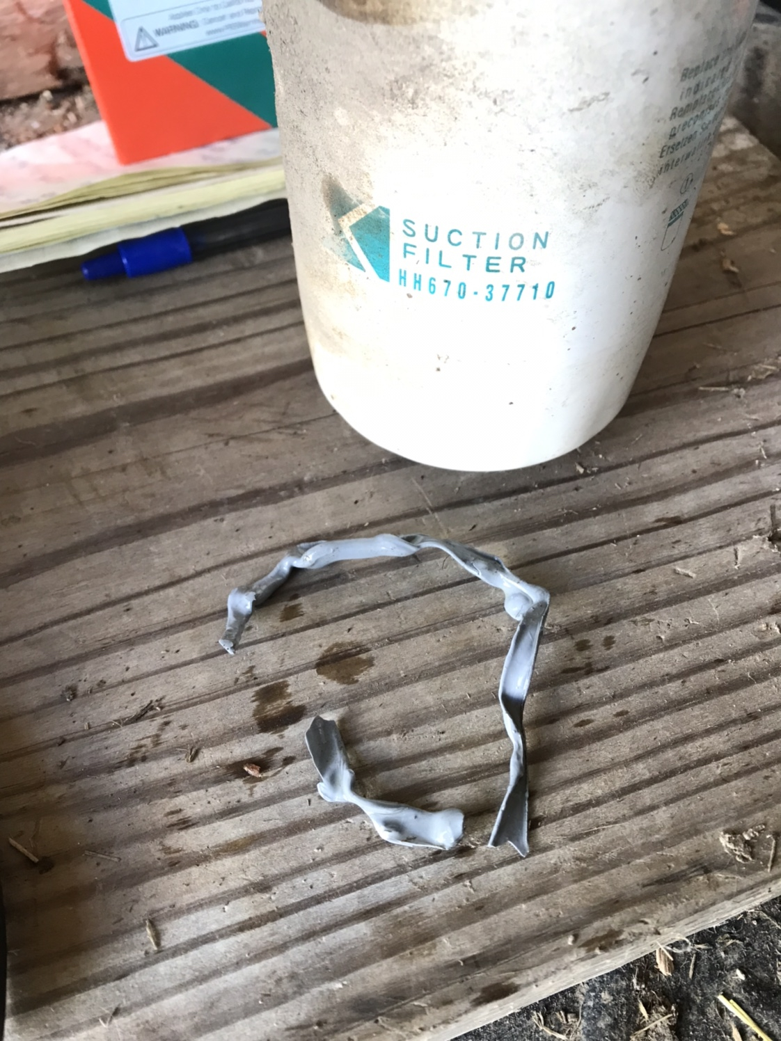

Doing the 400 hr hydraulic fluid and filter change, found this between filter base and hyd suction filter.
Someone at factory got a little sloppy with the RTV?

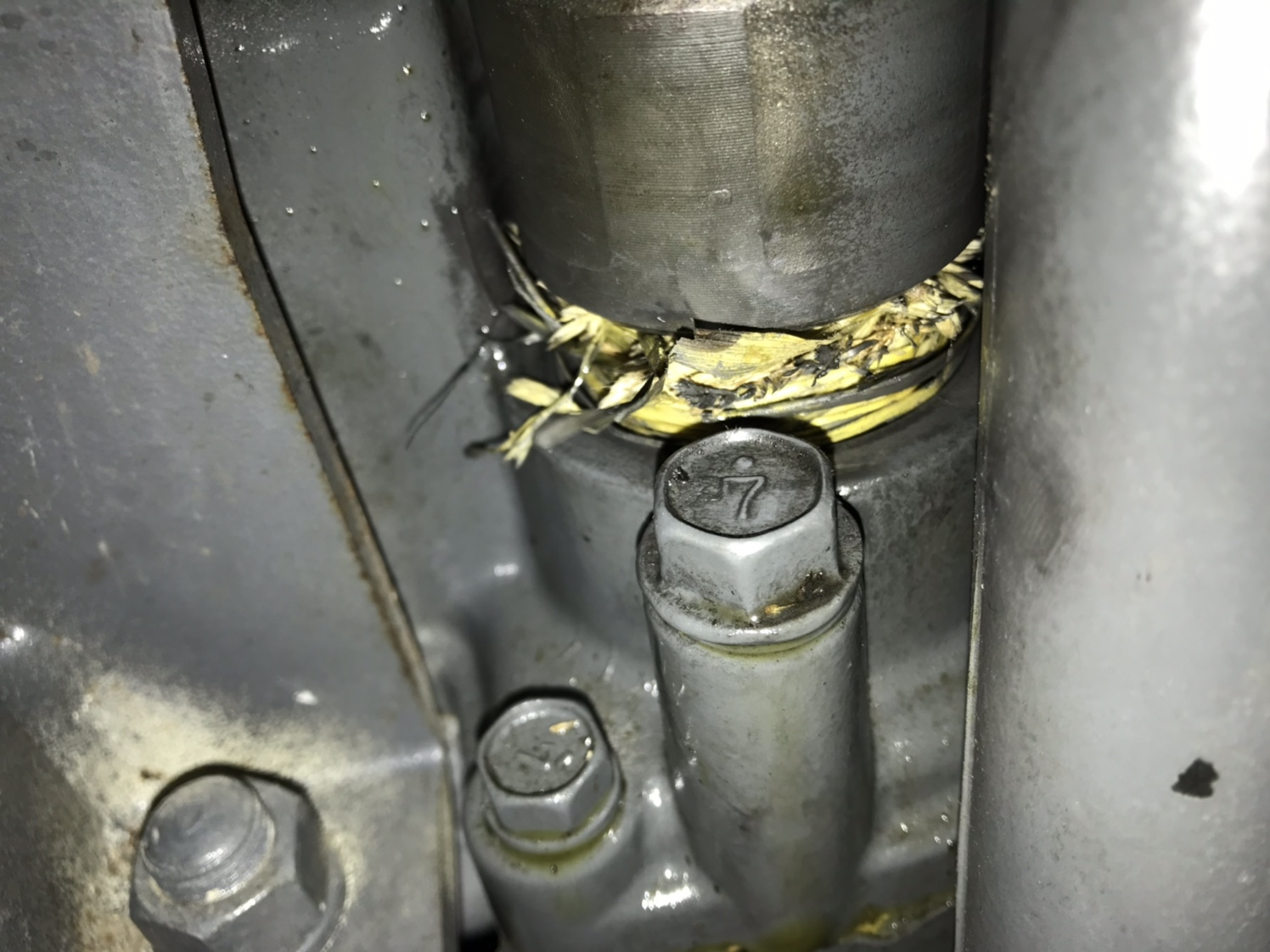

Also found this at rear of front transmission case, pretty common I suppose. Needle nose pliers, grab and pull.
Just thought I’d share.

I just changed the filters on my M7060 and there was a pretty big piece of RTV squeeze out in the filter. Probably only half of what you show.
   / Suprises found during oil changes #3
So they used RTV and a gasket? Sounds like a bad idea because it can squeeze into the filter and block passages.

It is reasons such as these that render the first service so important.
Regardless of what the book says, I change all lubricants and all filters at 50 hours.
