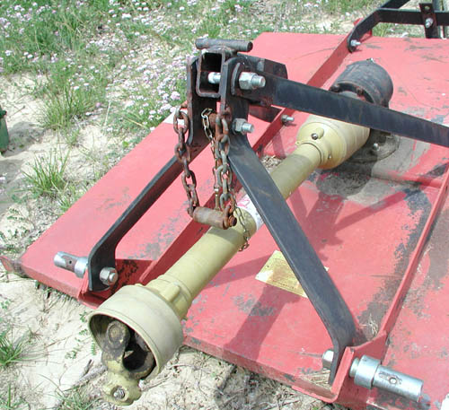

Like many of the others, I also have a Spee-Co quick hitch. For me the optional third link attachment (comes with quick hitch) shown in J. Miller III picture works great. On my attachments, the standard "hook" never fit the implement. I also have a hydraulic 3rd link and this makes it easy to attach. The Landpride hitch is of the same design as Spee-Co but IMHO not worth the additional cost. My Spee-Co cost $179 and came with one set of quick hitch bushings for the lift pins. Additional quick hitch bushings cost about $18 for a pair. On some of my implements, the quick hitch bushings won't work because they use essentially a 7/8 hitch pin for the lifting points. On these, I use a Cat I -II spacer and then use over this a Cat II - III spacer to get the proper 1 1/8" outside diameter. (The quick hitch bushings fit over a 7/8" lift pin and have an outside diameter of 1 1/8")

I don’t see how the SpeeCo Quik-Hitch or others like it would work on most finish mowers or bush hogs because they won’t allow the pivot at the top to move up and down. The top link needs to be able to move up and down freely. Am I missing something?

Mosey, Heres what works for me - finish mower same thing.
