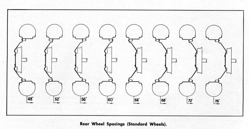

Are the wheel rims adjustable (bolted) or fixed/welded in one position? My 4105's are fixed, but many others can be adjusted by bolting them in different configurations:

View attachment 581380View attachment 581381My front & rear wheels have the ability to be set to eight varying widths as shown in the document posted by Wagtail. FORTUNATELY - I had the dealer set my rears wide( 80" ) and my fronts ( 64" ) at the mid point. My rears are loaded with RimGuard and weigh a tad over 1000# each. Changing the set of the rears is not a job I would consider a DIY project.
