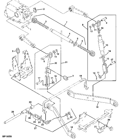

Bob,
Can you get away with any of the individua parts?
Or do you really need each sides complete assembly?
Here's a pic of that parts breakdown
/forums/images/graemlins/cool.gif

I had the same problem. The turn buckles you get from Lowes are not the same as you found out. You can buy the individual pieces if you can salvage any of the original parts. I replaced one end of the turn buckle and a clevis which cost me about $40. I felt your pain. The only other thing I can think of is maybe Tractor Supply Co.
