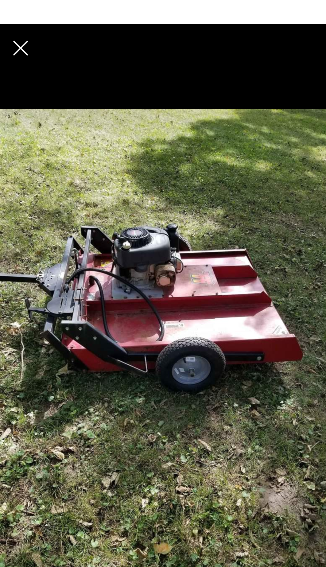

I have a 58 HP Massey that is too big for some of it and definitely not at home on slopes. The side hill areas are too high of a butt pucker factor. My 38 HP Mahindra would go most places but because I'd rather not drop the backhoe when clearing trails I decided to buy the Swisher. If it works out, great and if it doesn't I'll sell it or modify it.
