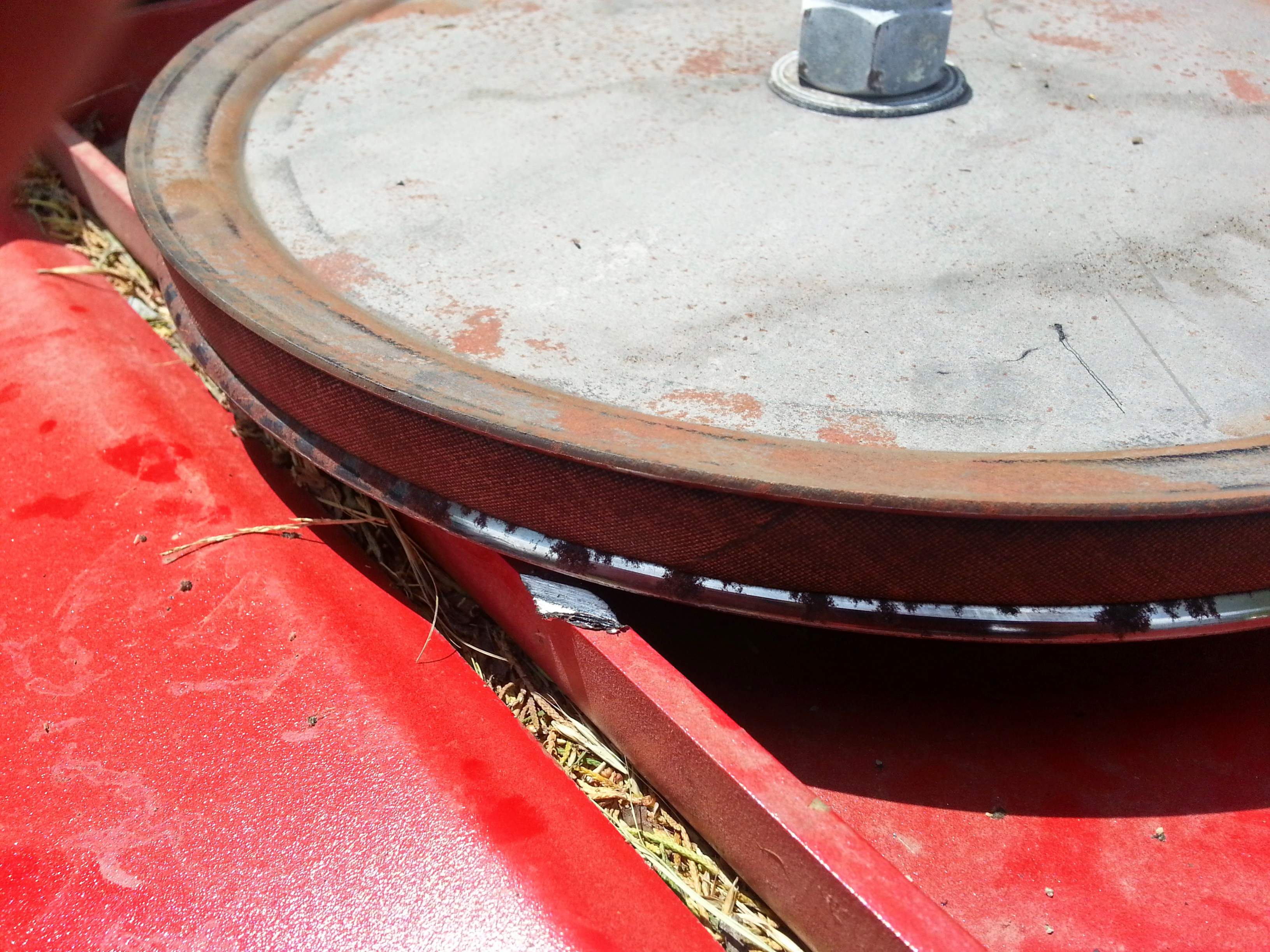

So, I was hauling this 52" Swisher Trail Mower behind a Polaris Razor to mow a field. All of a sudden there was this metallic scraping sound so I immediately disengaged the mower and shut it off.
In the bottom-right photo, you can see that the pulley began to grind into the metal of the mower deck. There were grinding marks like this at each of the four corners.
I'm trying to troubleshoot this so I can fix it, so I'd like to hear if you think that it's just a bearing that went bad or if the shaft got bent.
Any tips for disassembling the shaft would also be greatly appreciated!
Let me know if you have any questions.
Thanks for your help!
-Andrew

Looks like the top bearing failed and the whole shaft is dropping down and probably wobbling.
Remove the nut on top, the bolt on the bottom and see if it will come apart.
   / Swisher 52" Trail Mower Broken Shaft/Bearing (photos) #5
Probably a spindle bearing at top near the pulley. Remove pulley top nut and inspect, then remove remaining bolts under deck, after disconnecting spark plug and draining oil; if deck needs to be tipped, as stated.
