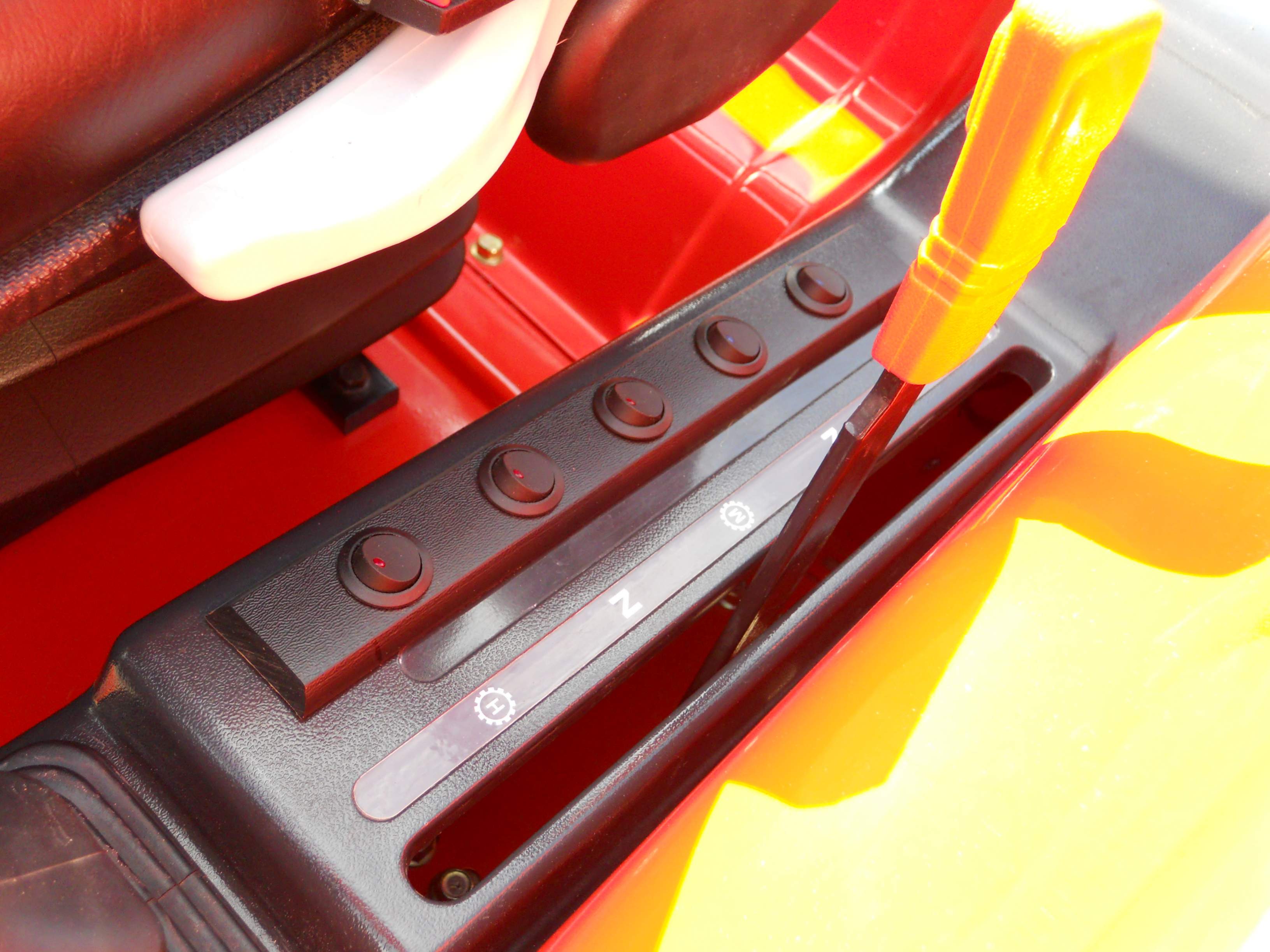

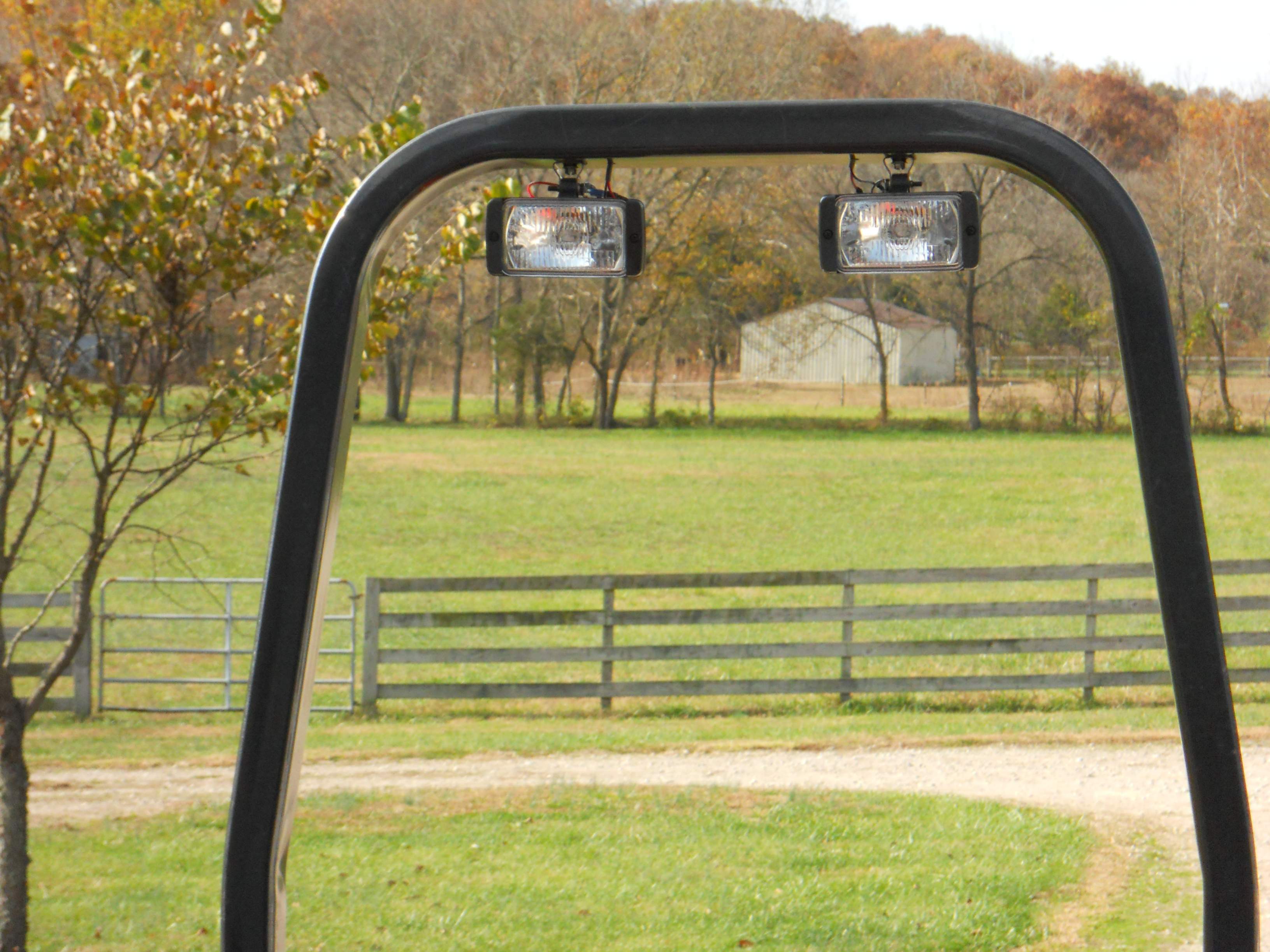

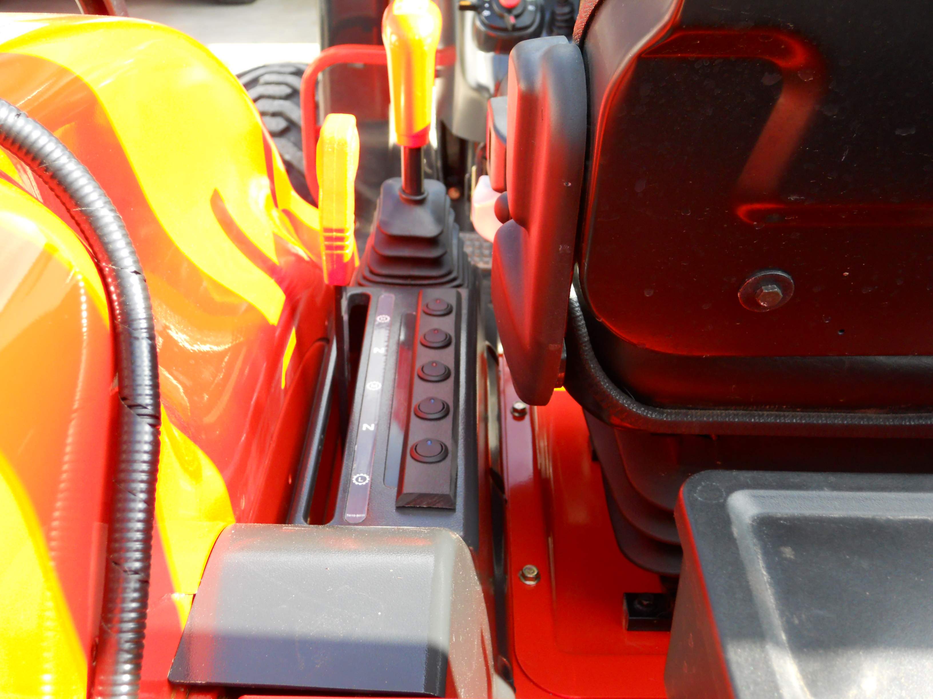

I wanted to add several switches (12v sprayer , ropes lights and rear work light ) . My 12v spayer I wired to 2 unused terminals on my trailer plug . So now its just plug and play. I ran a 30 amp circut with fuses to power acc. , with relays . I used the rear work light wires to power the relays as they are only powered with ignition sw on . I think the slot I used for the switches is for the granny gear option . The switch base was made from a old peice of body side molding .

That's a nice piece of work! Would like to do something similiar as I round out my accessories... Great idea of using some body molding, would have never thought of that. :thumbsup: Now I need to get some thoughts on paper for mine... ;)
   / Switch option #3
A well planned and well executed install. Nice choice of switches also.:thumbsup:
James K0UA
   / Switch option #4
Man that is sweet. I like it a lot. Great idea.:thumbsup:
