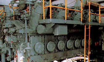

Do a google search on CNG Cars. Lots of hits.
I spent many years working at a place that used natural gas to fuel two cycle Cooper Bessemer natural gas compressors.
