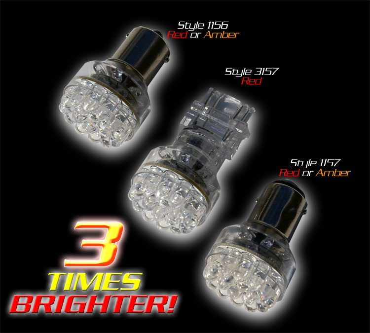

You can get plug in LED lights for 1157 and other style bases but you'll need to replace the flasher with an eletronic one. Bulbs and flashers are plug and play.
